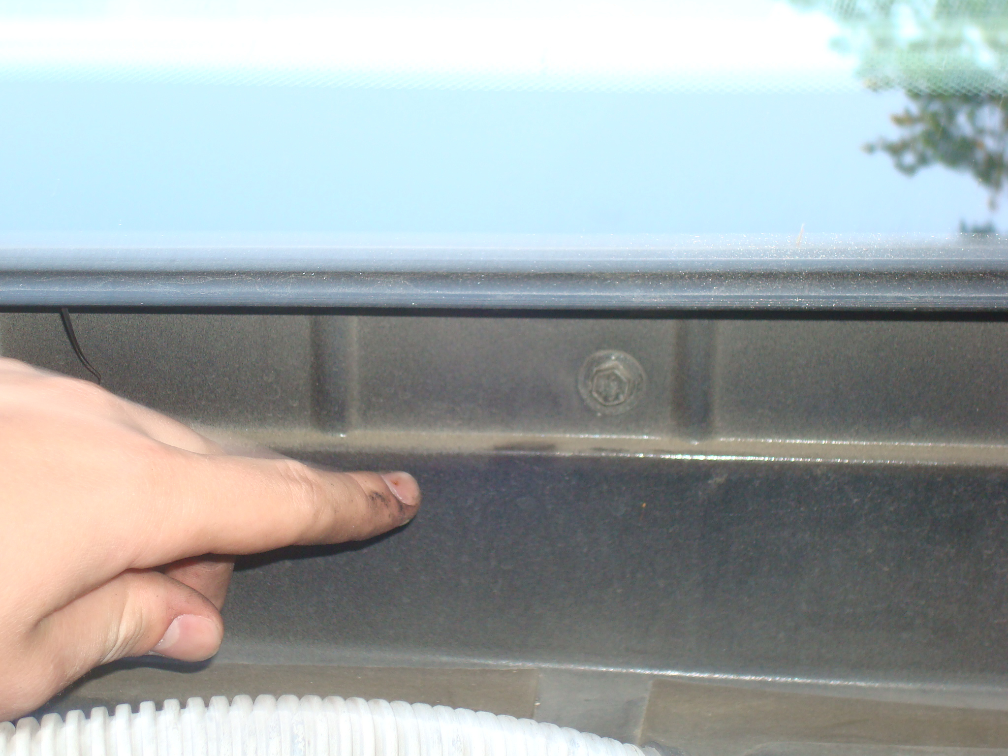

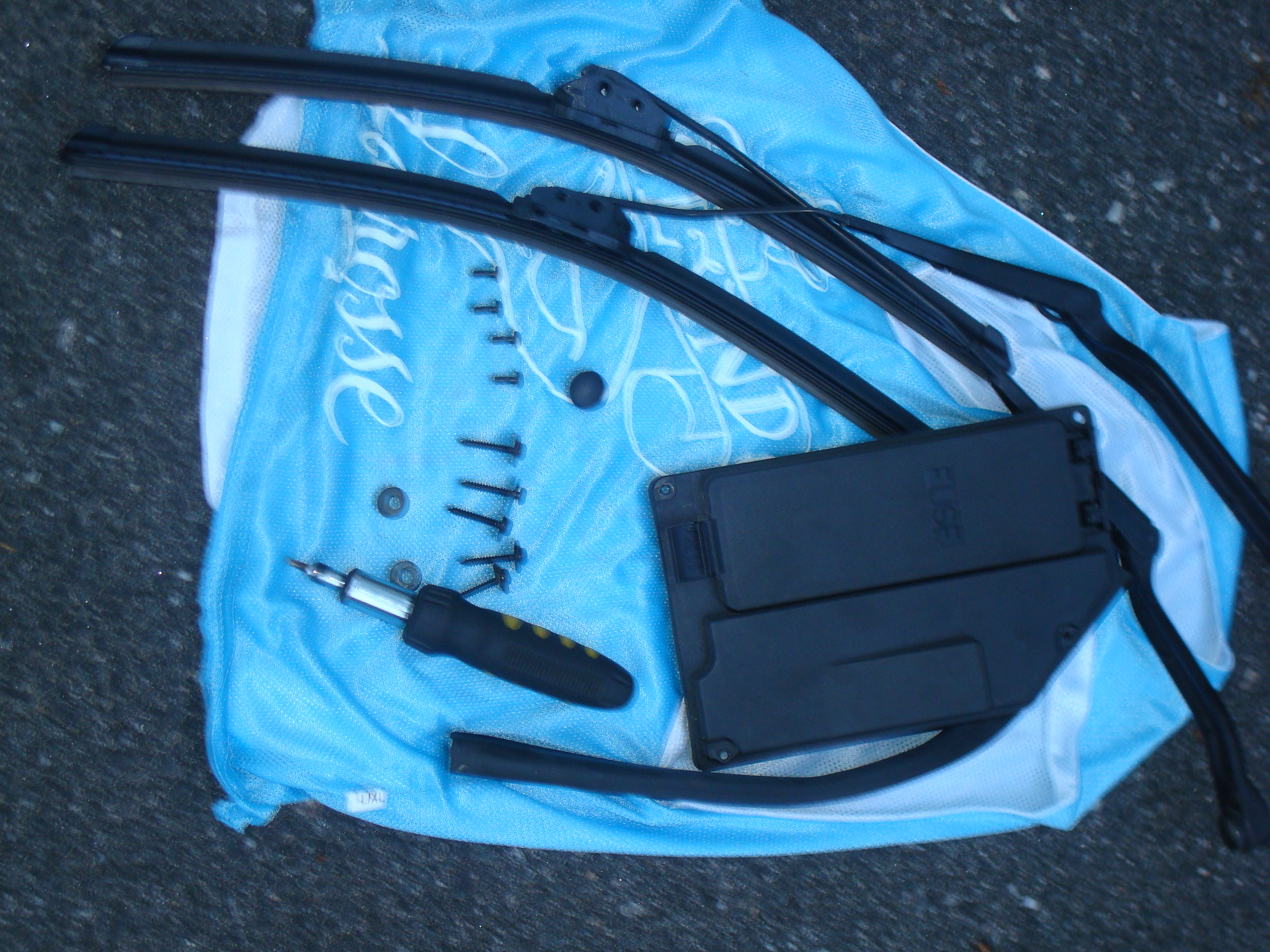

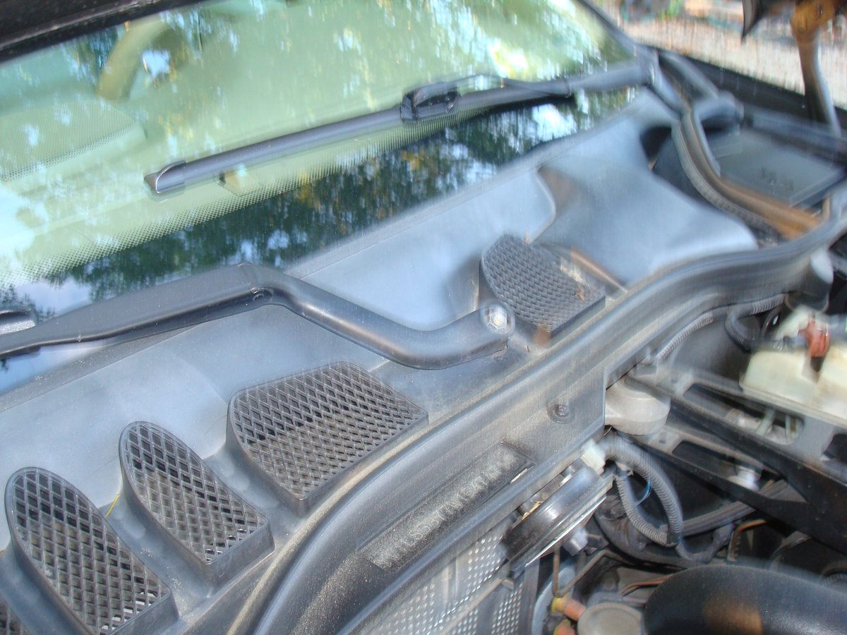

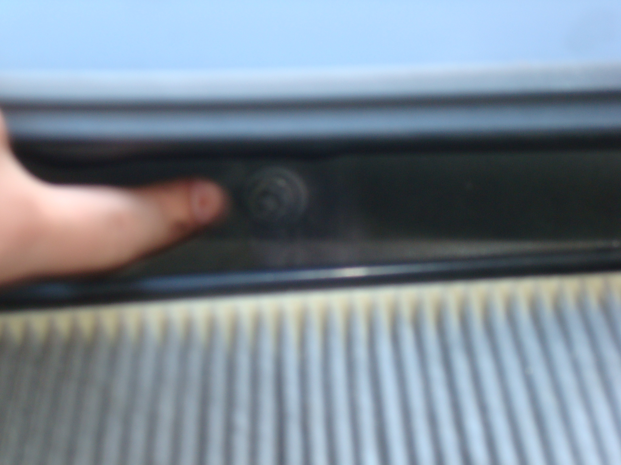

Hey guys, it was really nice today so I couldn't resist spending a little while to tighten up the firewall screws as suggested. I also said I would take pics so here they are. Note that I don't know what I'm doing on the forums yet so the pictures might be in reverse order...
Screw 4 was actually pretty easy to turn compared to the others, I probably got a full 1 1/2 turns out of it before I didn't dare to tighten further. Because it was loose I figured hey, maybe that did it! Goodbye noise!? But no. After driving the car again there was no relief from the torture at all. So, as I said before I am going to take the top of the dash off to see what I can try and fix. I'm wondering (Lee) can I find those clips by just taking the top part of the dash off? I'm starting to think that's my problem. I will be following your guide on dash mount repair if so. The only part about taking the top panel off I'm worried about is the passenger airbag, suggestions?
Thanks all!

No
Those 4 screws are just for the dash cap.
The clips that break are part of the entire lower dash, the same dash you remove to do an evaporator.
To repair these (and they can be jury rigged not to make noise) you must remove everything as if you were doing an evaporator.
HUGE nasty job
We just did one (but we also were doing an evaporator).
My guy made up a "cage' and epoxied it to the dash so it could be screwed back together.
Two "clips" were shattered
HUGE nasty job
