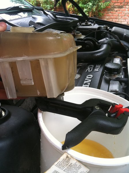

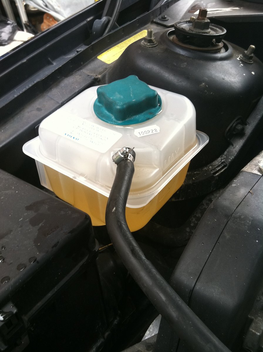

Ok, as promised (don't know if you still need it or not, but it may help others). I wish I had Photoshop on this computer, but I never got around to putting it on.
This shouldn't take you more than 20 minutes, even if you have no idea what you're doing.
Start by cutting this clip on the upper line (I use cutting pliers like the ones shown here). Take that upper line and place it over a bucket. Lift the tank itself directly up off its mounting point off the fender, unclip the sensor line from the side of it and hold it up in the air as far as it will let you; the remaining coolant in that tank will drain through the small line into the bucket. Once all the coolant has drained, unscrew the hose from the bottom and remove the little float sensor from the tank. Replace those into the new tank, bolt it back up, and fill with a 50/50 mixture of coolant and distilled water. As you can see here, I used a small screw-type clamp to replace the one I cut off. You can find them at any auto parts store for like $1 for a pack of a few of them.

Thanks for the tuitorial, I just replaced mine yesterday, it's a pretty easy thing to do.
Are you using a coolant that is safe for aluminum engines? Mine is a mint-green color, similar to mountain dew, I believe anything else will eat away at your engine and might eventually crack the block.

That's Zerex. It's a HOAT-certified coolant that's what's called for in these engines.
It does look like straight piss in a bucket though
