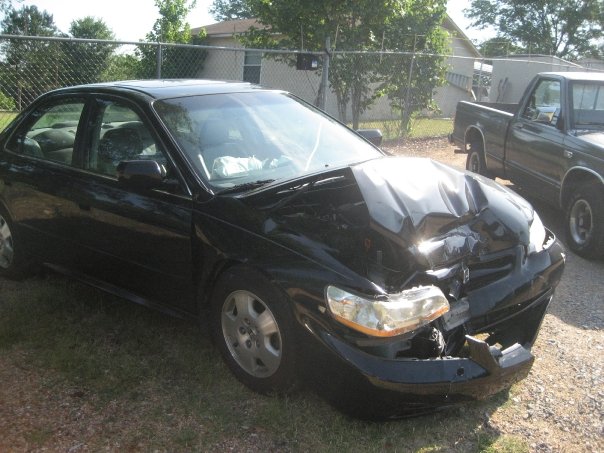

Not sure if even having ABS can save you from stupid drivers sometimes. My sister was hit head-on by a drunk driver a few years ago - here's her old car
'98 S70 T5
2016 Chevy Cruze Premier
It's best to have functioning airbags, you can never predict when someone else's behavior or decision will cause you to end up in a wreck.
