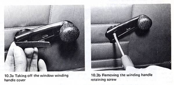

In other news, I was at the parts yard this weekend and was lucky enough to find a donor car of the same year. I got to practice taking off the door panel and check out the wires leading to the door lock. Why did they use biodegradable wires?? The wires in the donor car were just crumbling, and I fear that mine will look the same. One more question about getting that door panel off...whats the trick for negotiating the window crank? I couldn't figure it out, so I had to rotate the panel around it, not something I'd want to do with my vehicle as it seemed to compromise the panel.

Here was I naively thinking that only UK cars still had manual windows so I didn't mention them. These are from Haynes:
Window winder removal.jpg (27.16 KiB) Viewed 980 times
Gently prise out the cover with a small screwdriver at the forward end.
