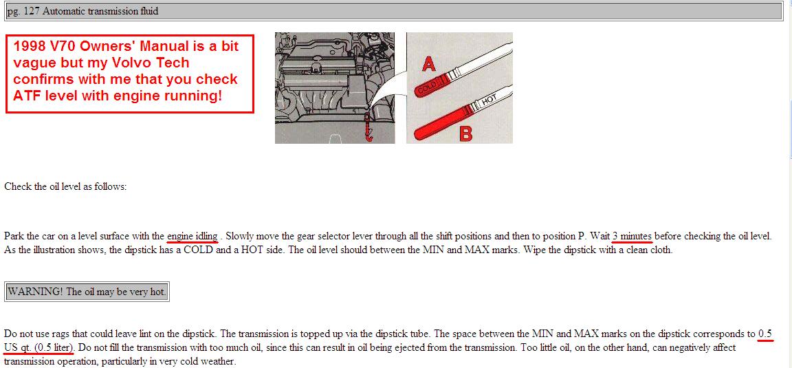

The owners' manual is a bit vague but my Volvo Tech confirms with me that you check the ATF level with engine running (after you have shifted through all the gears).

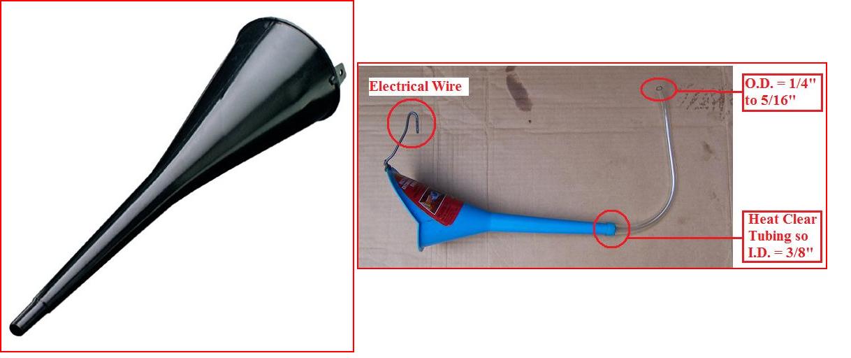

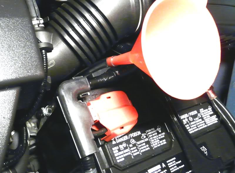

When I wrote the DIY ATF Change for my 2007 Honda Odyssey Van, I had the exact same issue of slow fill through the ATF dipstick in the Honda (which is even smaller than the 98 Volvo V70 dipstick!) Not a big deal but it was slow.
But some people came along with some “red-neck engineering” that I loved it! This allows a faster fill of ATF!
See this thread. Pay attention to threads by varads and cnn:
http://www.odyclub.com/forums/14-period ... uid-8.html
Basically they suggested that you find a tube/funnel whose I.D. fits the O.D. of the dipstick housing. Sure enough for the Honda Odyssey van, these ideas work:
1. “Blitz” Black Funnel
2. Clear Vinyl Tubing whose I.D. fits the O.D. of the dipstick housing
See pictures of these ideas. NOTE: These are from 2007 Honda Odyssey, I have not tried this on my 98 Volvo yet, but the idea is there. Maybe someone can try it and report back.
