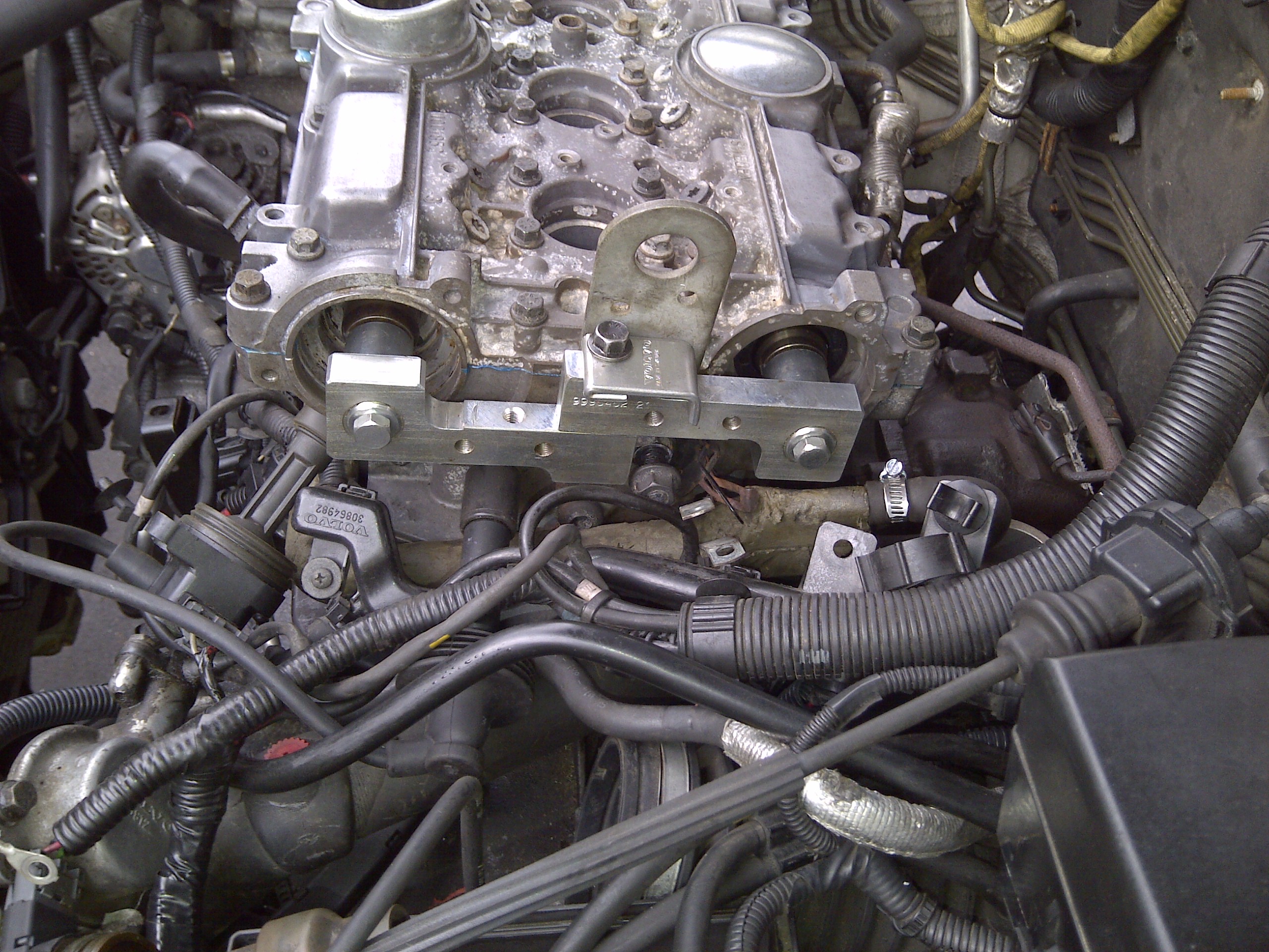

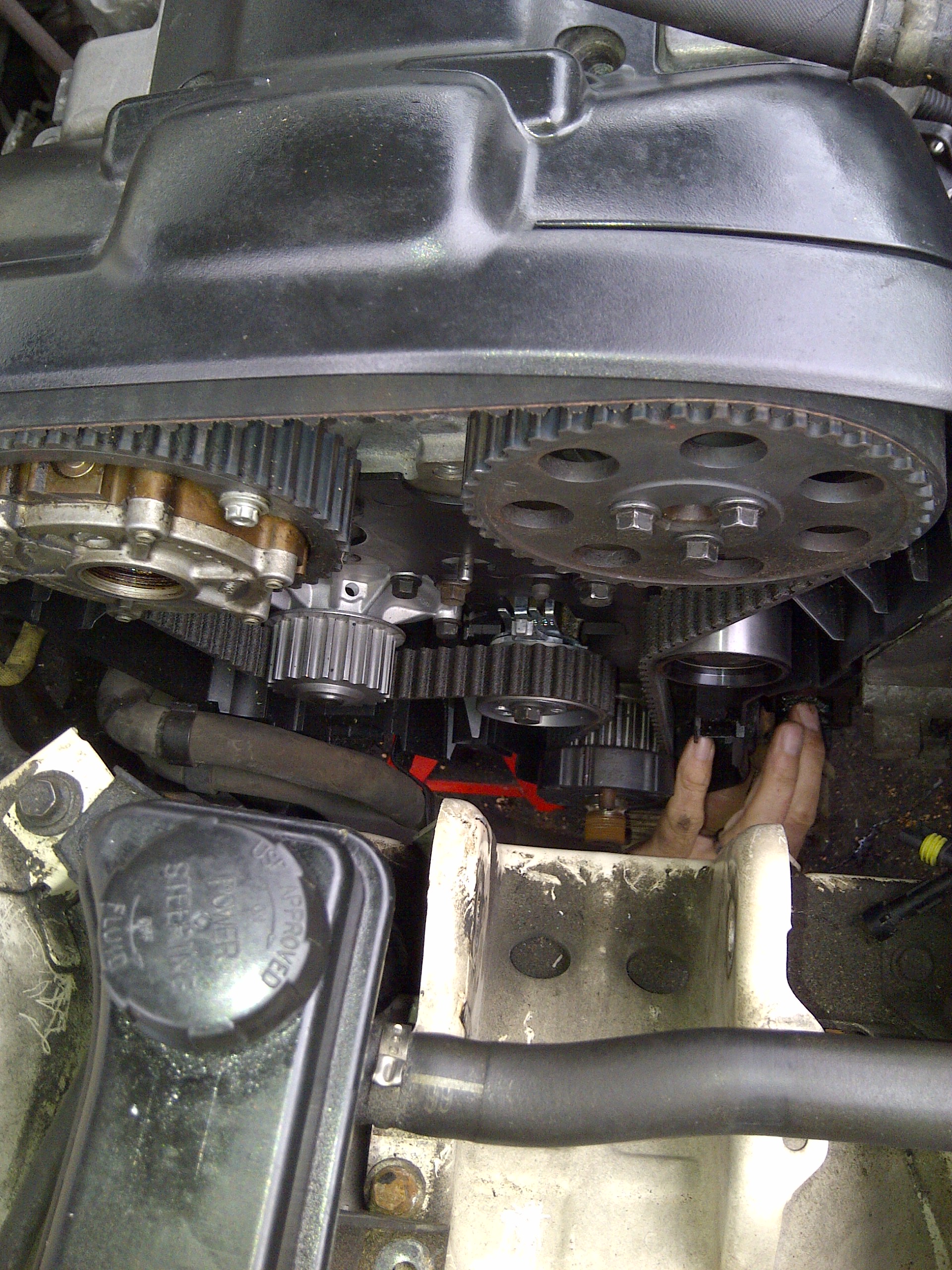

She is finished. There is a small oil leak coming from the turbo, so that will be fixed today. (way to hot after a test drive to mess with that). The engine is quieter then when I picked up the car at 100 k. With 166k on the clock, it is almost like a new engine. Here are a few pictures:
Timing Spot On
Timing Spot On
Volvo Cam Timing Tool
