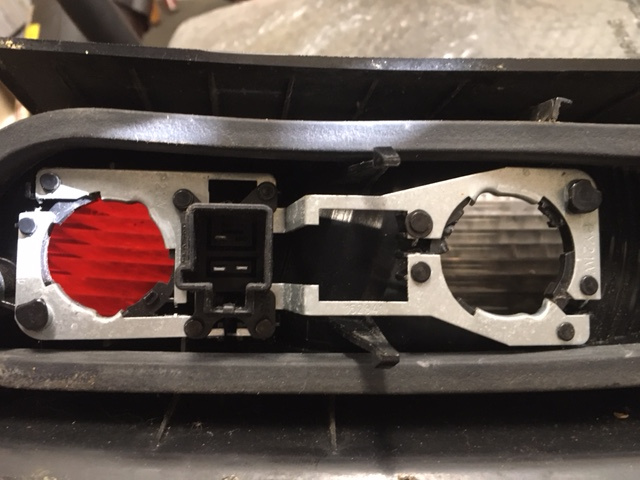

I had this happen to me once so this might be worth checking.
You will need to remove the tail light lens to confirm, but the metal contact to the bulbs shifted due to plastic tabs breaking that hold the metal plate in place. The metal plate is held by many plastic tabs (not screwed in). If a few break, the metal can move and you don't get a good connection. Sometimes, just removing and installing bulbs can can cause a weak tab to break.
rear tail light lens, backside
Rear tail light.JPG (103.73 KiB) Viewed 5666 times
