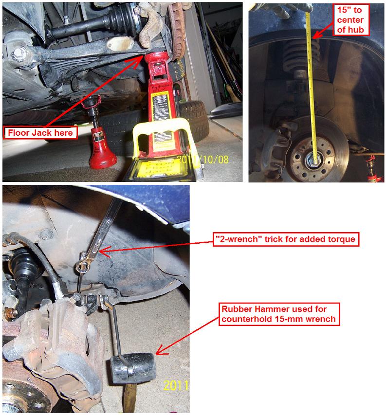

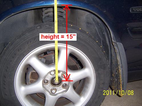

1. With on level surface, measure the distance between Fender and Center of Hub.
In this case, it is 15":
2. Then with car on jackstand:
- Use a floor jack below the control arm and jack it up until you get 15"
- Note also the "2-wrench trick" for added torque:

Thank you very much for the visuals, I'll give it a shot right now.

Okay, when I got to the point that I had another inch to go to reach ride height the entire car lifted off the jack stand and I couldn't close the gap the last inch. I had the floor jack positioned so that it avoided the cap under the ball joint. Does it need to be positioned all the way to the end of the control arm, below the cap? The weight of the car won't crush the cap? Thanks!

Actually you are right to avoid the cap, it can be crushed.
One inch from ride height is fine, you can tighten the bolts when the arm gets to that level.

Thanks for the reply I was worried about that. I ended up putting my floor jack under rotor, that extended area off the brake area that extends for the lugs. Then there was no problem with hitting the mark.
