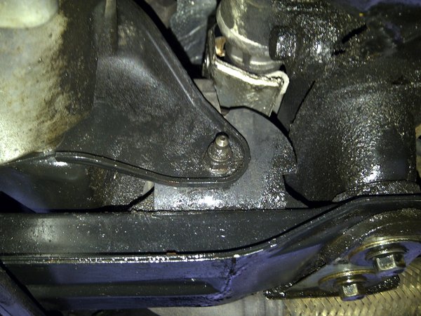

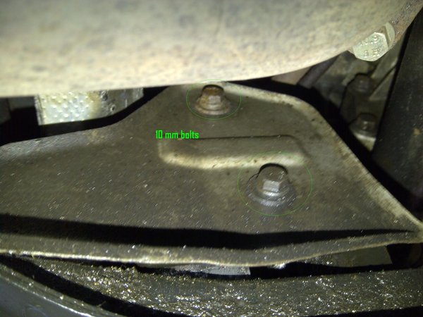

First, we are going to remove the subframe and cross member under the car. Start by removing the 2 bolts holding the cross member on. Once that is out of the way, you will need to remove the heat shield over the rear engine mount.
Next we will remove the bolts through the two motor mounts, both front and rear.
After both mount bolts are removed, you need to remove the 4 bolts from the subframe. Two in front, two in back.

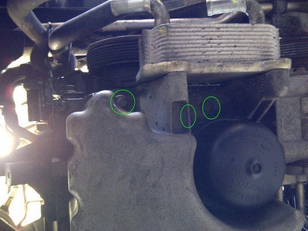

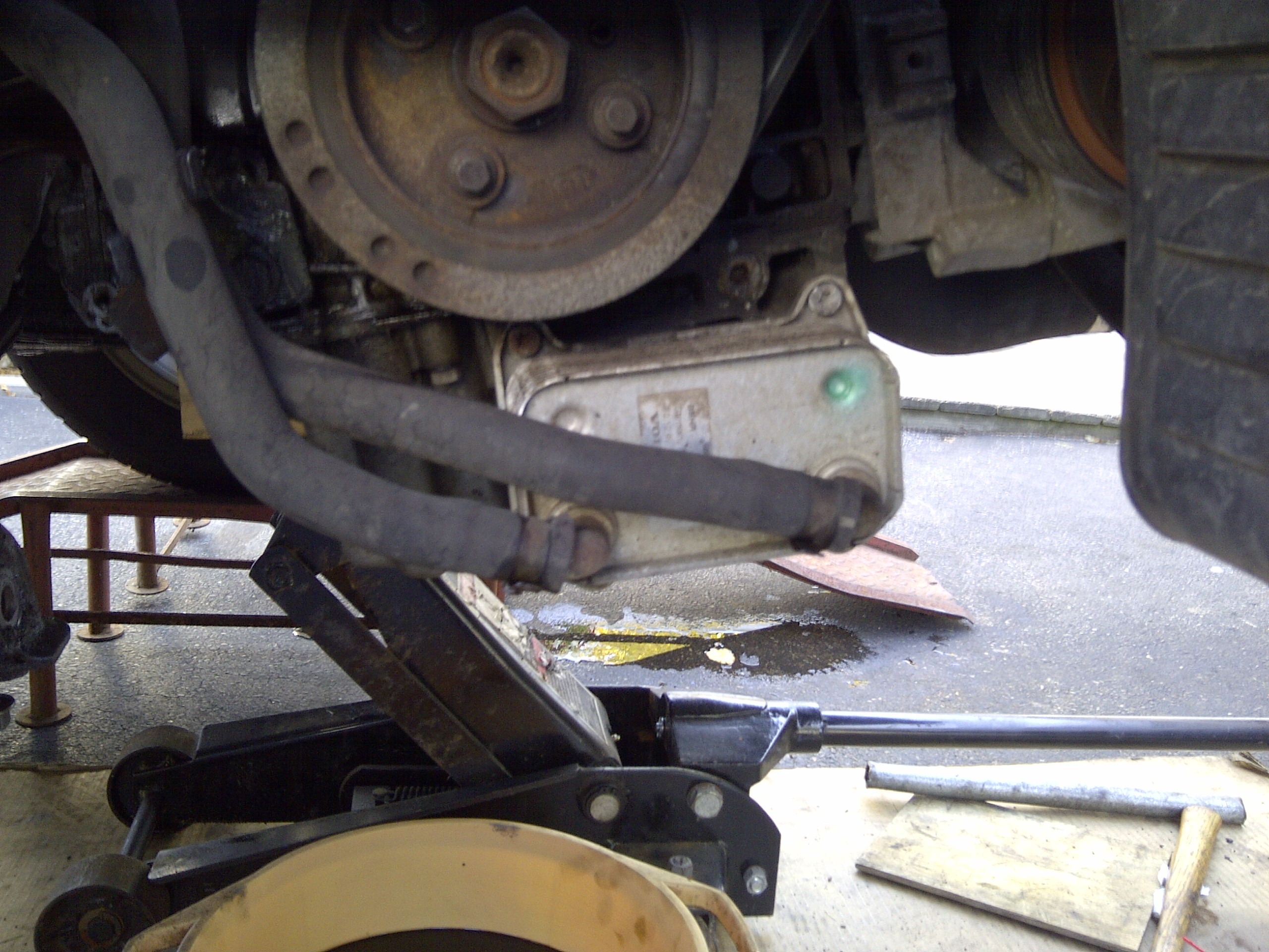

Once the member is dropped, we will move on to the oil cooler. We will leave the oil cooler attached to the oil pan since the o-rings to the oil pan are $10 each from Volvo. We will just disconnect the two coolant hoses. It will have more coolant in it, so be prepared to catch it.

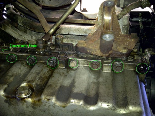

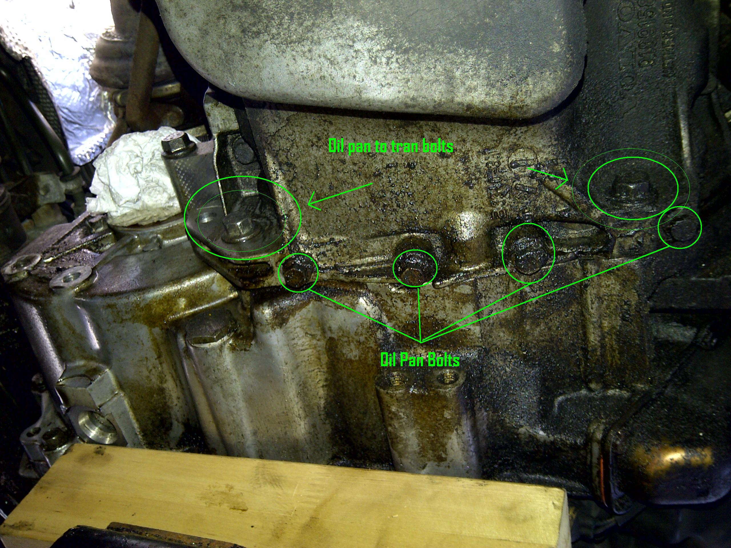

Now, on to the oil pan. Remove the two bolts to the trans, 14 mm. Now, we will loosen all other bolts, but do not remove them. Remove tension. Here are the locations of the pan bolts.

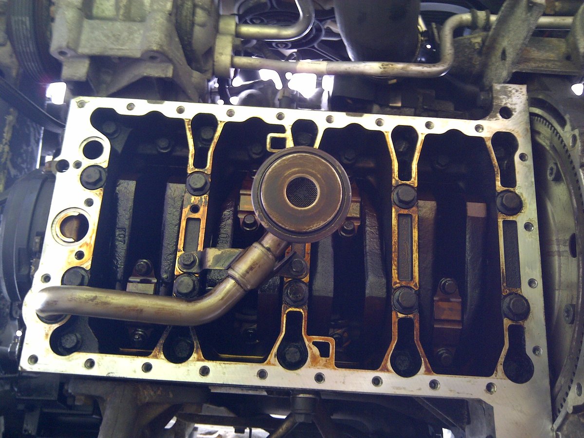

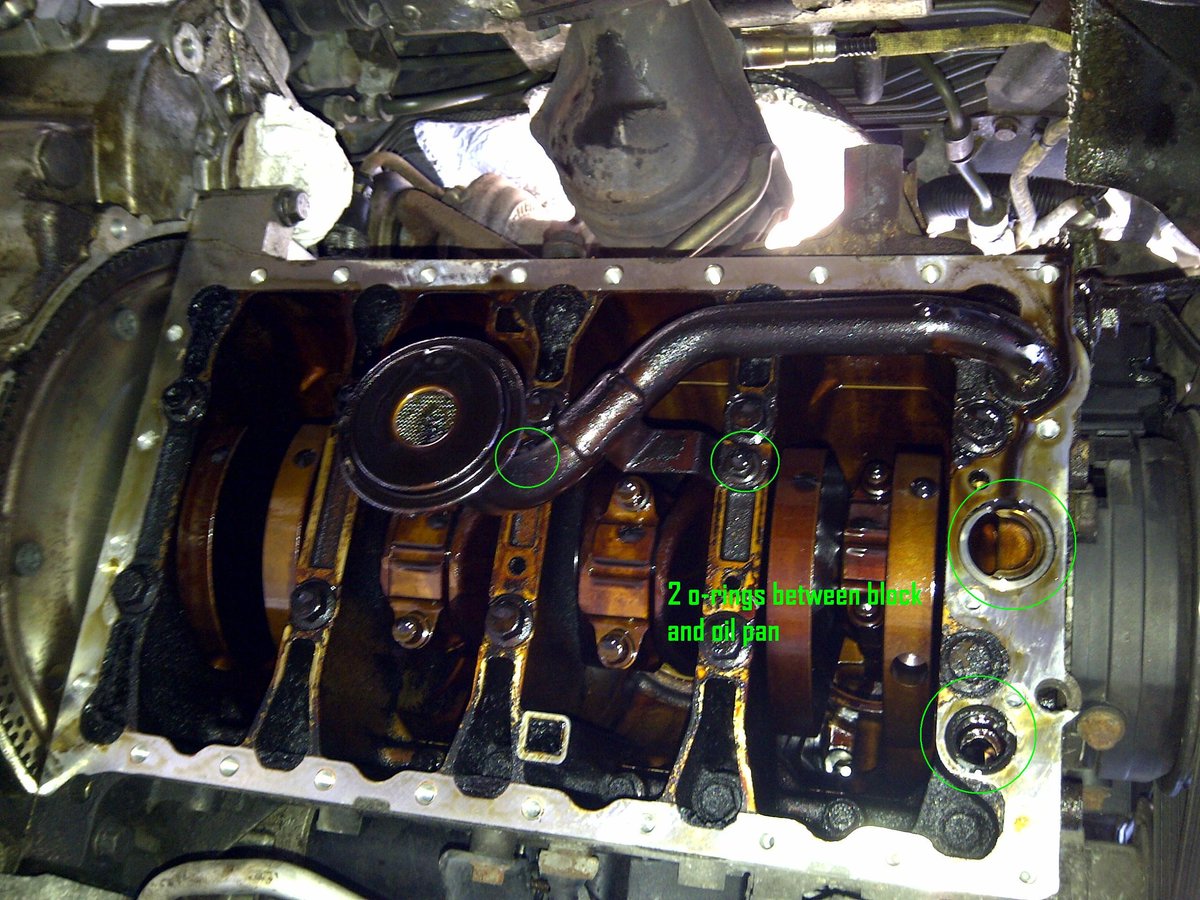

Now, once all bolts are loose, remove all bolts except 1 in each corner. You will leave these on, so you can use a rubber mallet to hit the oil pan and loosen the pan. Once it is loose, you can remove the 4 bolts and drop the pan. It will have to come down then a little toward the trans to clear the oil pickup. Once it is removed, you will see something like this.
Remove the two bolts holding the oil pickup tube and remove.

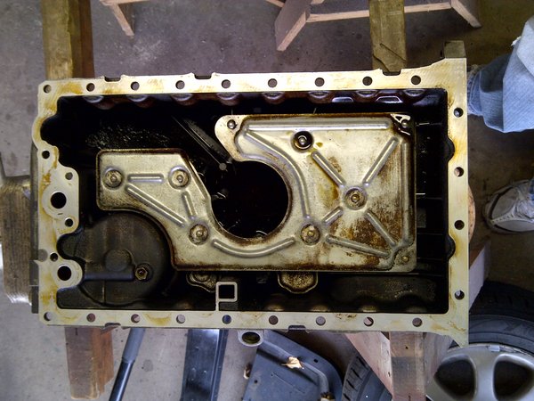

Now, be sure to clean up both surfaces and replace the o-ring on the end of the oil pickup tube also. Clean the screen also.
You will need to use the anerobic sealer on these parts, so be sure to put a think film on both surfaces. Insert the 4 corner bolts and finger tighten them to make contact between the oil pan and block. Vadis says to install the two 90 mm bolt to 25 NM then 48 NM, but I broke a bolt tightening to 48 NM, so I kept them at 25 NM. The other short bolts should be inserted and tightened to 17 NM in pairs of two working away from the trans. When you get to the 40 mm bolts, just insert and tighten to 17 NM also. NOTE: Be sure to apply thread sealer on the 100, 90, and 40 mm bolts. Replace the two coolant lines to the oil cooler.
