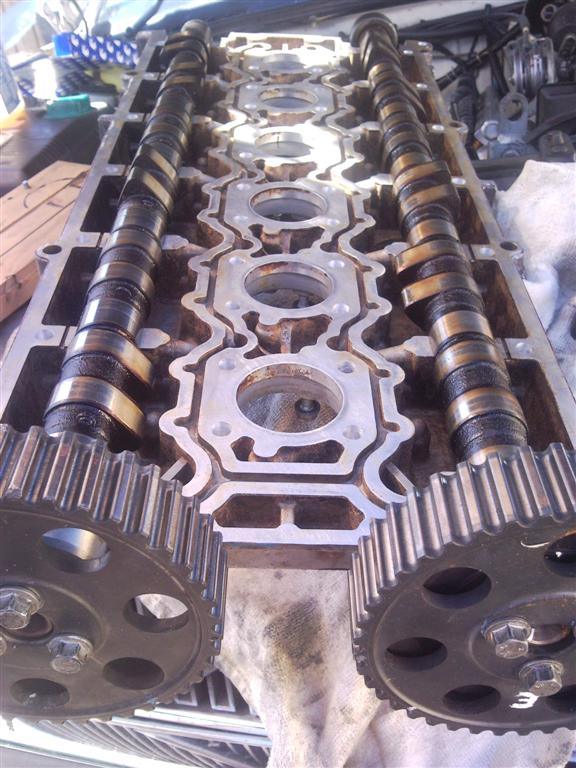

Hey precopster,
well,I finally tackled the project today. I have the cam cover off. I was expecting the cam shafts to be loose after I revoved the cover, but they are sitting in there pretty tight. I'm wondering if I can just clean everything off, apply the gasket, replace the o-rings and put it back together without pulling the cam shafts up?
Strange...They should be loose. Nothing holds them in once you have the valve cover off. I would actually want to remove them to check the condition of the lifters and give them a good clean.

Very strange, the strength of the 24 valve springs acting against the lifters is quite strong and should dislodge the cams. As Choguy03 said I would want to check them but while they are down it makes putting everything back together very easy without needing cam locks at the rear .
Cleaning around them will be very difficult as you want to get the surfaces pretty spotless.
Good luck. Can you take a photo and post it?

The cam can bind up on the thrust flange at front. The cams will be up at rear but stuck up front.
I see a piece of the thrust face on the head broken off on the right side in second photo posted. Look just behind where the seal would go at front of head. That is where it hangs and can break off a piece. The missing piece is of no consequence.
