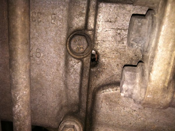

My '94 850 turbo wagon w/143k miles has an oil leak that's bad enough that the front of the gas tank gets oily! After driving, I'll put it up on ramps and crawl under: there's always several drops of oil hanging down from the rear of the oil pan. I wipe them off, then wait for them to start forming again...but they don't. What might be the source (because they look wet, even after wiping them off) are both the seam between the oil pan and the lower half of the block, and the seam between the lower and upper havles of the block. Is there a reason either of these would leak only while the car is being driven? I recently replaced the "right" (front) engine mount, which involved jacking up the engine via the oil pan: I'm wondering if this could have compromised the oil pan gasket (or is it just sealant?)
If it's coming from the upper/lower block seal (or gasket), is there some kind of sealing coating that might be spread over it, to stop the leak?
Thanks for your input!

Oil leaks can be very hard to track down, as it looks like it comes from just about anywhere.
By this amount of oil, though, I think you've got blown seals (led to by a clogged PCV system desperately in need of help).
Check out this one first. Is there oil in the vicinity of that metal plate or on the hoses below it? If you remove it, does the cam seal fall right out into your hand?
There's a weep hole in between the engine and transmission - IS oil dripping directly from there? If so, you've got a leaky RMS, and may need to decide just how much you like your car and want to keep it. A RMS repair can run upwards of $900 as the transmission and engine have to be separated.

I had all kinds of oil coming from the back of the S70 motor and found a small access panel leaking. Oil was blowing everywhere. The kit cost about $8 from the stealer, maybe less at yours. Easy fix but hard to find.

rspi: I saw your post in another thread, while researching this. What I’m planning to do is clean off the back of the engine with my “Steam Buggy” to see if the source of the leak becomes more evident. You’d think it’d pretty straight-forward, ya know? And what are those plates on the back of the engine for, anyway? Connecting rod and/or crank inspection?

I have no idea what the ports are for. I had to wipe my motor down several times and put it on ramps. I don't think I seen the leak until the car was running and on ramps. I seen the oil seeping out. I may have even had my wife reving the motor a little.

Post by chax »
