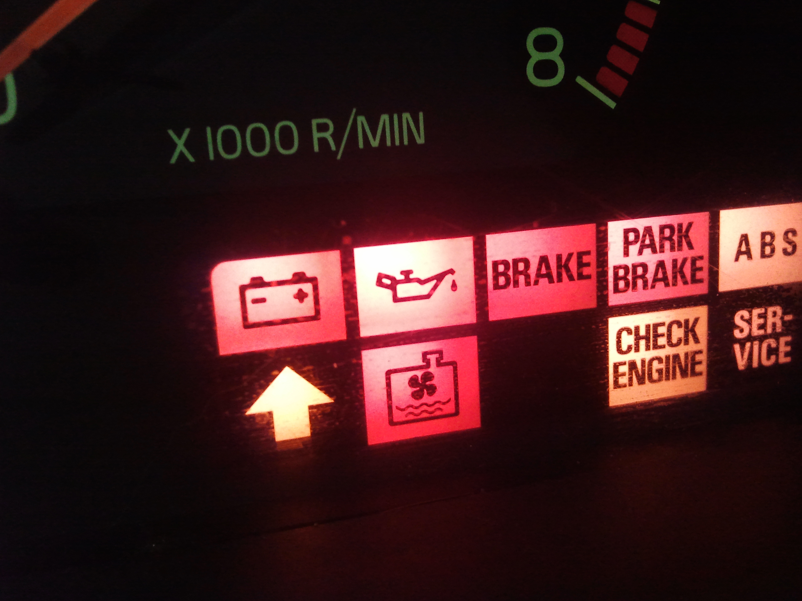

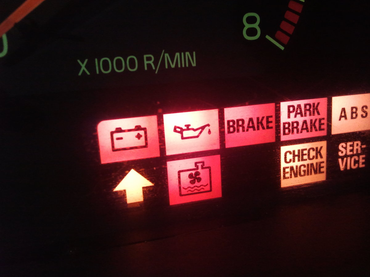

Uhoh... A new warning light flashed on for a second.... i keep getting problems. i also have delayed throttle response. could cleaning the throttle body help? anyway...this scared me...
The one next to the arrow and blabk space (is that supposed to be there? no? what is it then?)
I think this is a clue to my current problem...
Judging by the rough symbol, it might be the radiator fan not working.

Also, what does the light mean?
