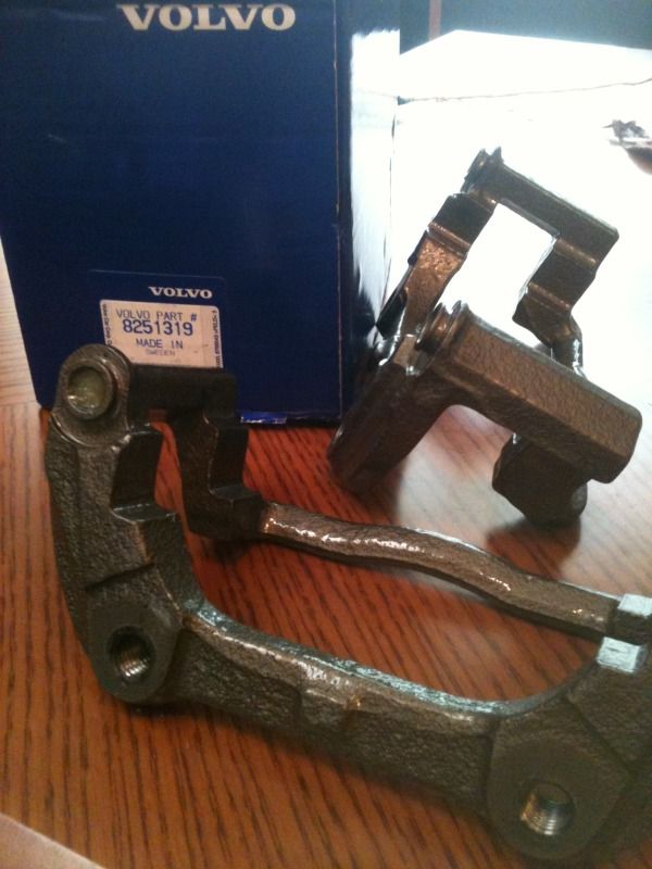

Last time I checked, OEM brackets are less than $50 each. There are two types, each with a different part number, the only difference I believe are the finishes on them. 8602456 or 8251319 both should work.

I just picked up a `96 850 Turbo and was attempting this conversion with the #8251319 Volvo bracket, and the stock Ate caliper...it seems in no way correct - it seems to feature a sliding pin design more like Girling calipers I've rebuilt. I assume I now need the other bracket mentioned afterall? The #8602456
