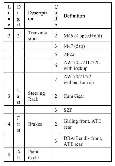

The component ID plate on the 'B' pillar (left side passenger door jamb) will tell you what brakes you have front and back and which steering rack you have and a few other things. Your local and on-line parts supplier can help you if you can help them with your car's info.

Look at the Product Plate located on the passenger's side of the front radiator cross brace which has the following additional information in the five lines on the right of the label

Thanks for your input that label is missing on my car,if you or any member could tell me how to contact Volvo to get the information on Rotor size and caliper brand for a 1987 760 turbo sedan 4cyl. I would be very grateful.
