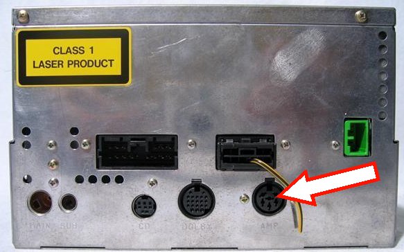

There are several things to consider here.
As stated, the SC-900/901's do NOT have internal amplication
for the 4 corners and must be used with an external amplifier.
( They do have a 1 x 25w amp for the Dolby center channel, but
if you haven't got the center speaker or Dolby module, no biggie ).
The unit should work with any of the various factory optional 4 channel
OEM amps in 800 and 70 series Volvos using the 6 pin DIN cable ( that plugs
into the connector on the back of the HU marked AMP ) and the correct
speaker bypass adapter cable. Just because it says PREMIUM on the radio,
there's no guarantee that you have an external amp.
If you are hooked up with the OEM amp, you'll have the 6 pin DIN
cable and the "B" connector at the HU will only have one lead and many
empty contact spaces. Should look like this:
This is the AMP connection:
I have all of those plugs except for the middle "Dolby" one and the green socket. Again, the Platinum's did come with the external amp! I do have it!
