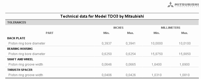

Here's some info on the Mitsubishi TD03-8G for you....
Free play Tolerances
Radial: 0.009" (0.223mm) - 0.019" (0.483mm)
Axial :0.0015" (0.038mm - 0.003 (0.076mm)
Wastegate Actuator pressure: 6.5PSI
This kit "might" work, check with them first: http://baeturbosystems.com/turboservice ... ent-2.aspx
Gpopshop stock rebuild kits too, although there are not listed on the website so use the contactus form: http://gpopshop.com/contact-us/

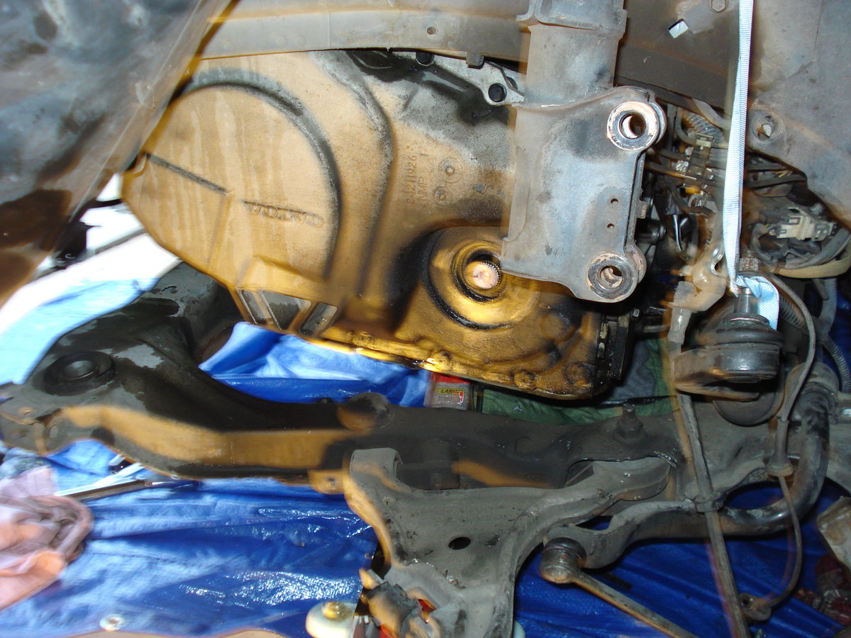

i have attached a few pix, everything is ready for the tranny to drop down, this part is tricky, i cant find the floor jack attachment as mentioned in the VADIS pdf file, in order for me to safely lower the tranny, so im a little flustered .... but it will come out :evil:
4T65E/GT ready to come out
