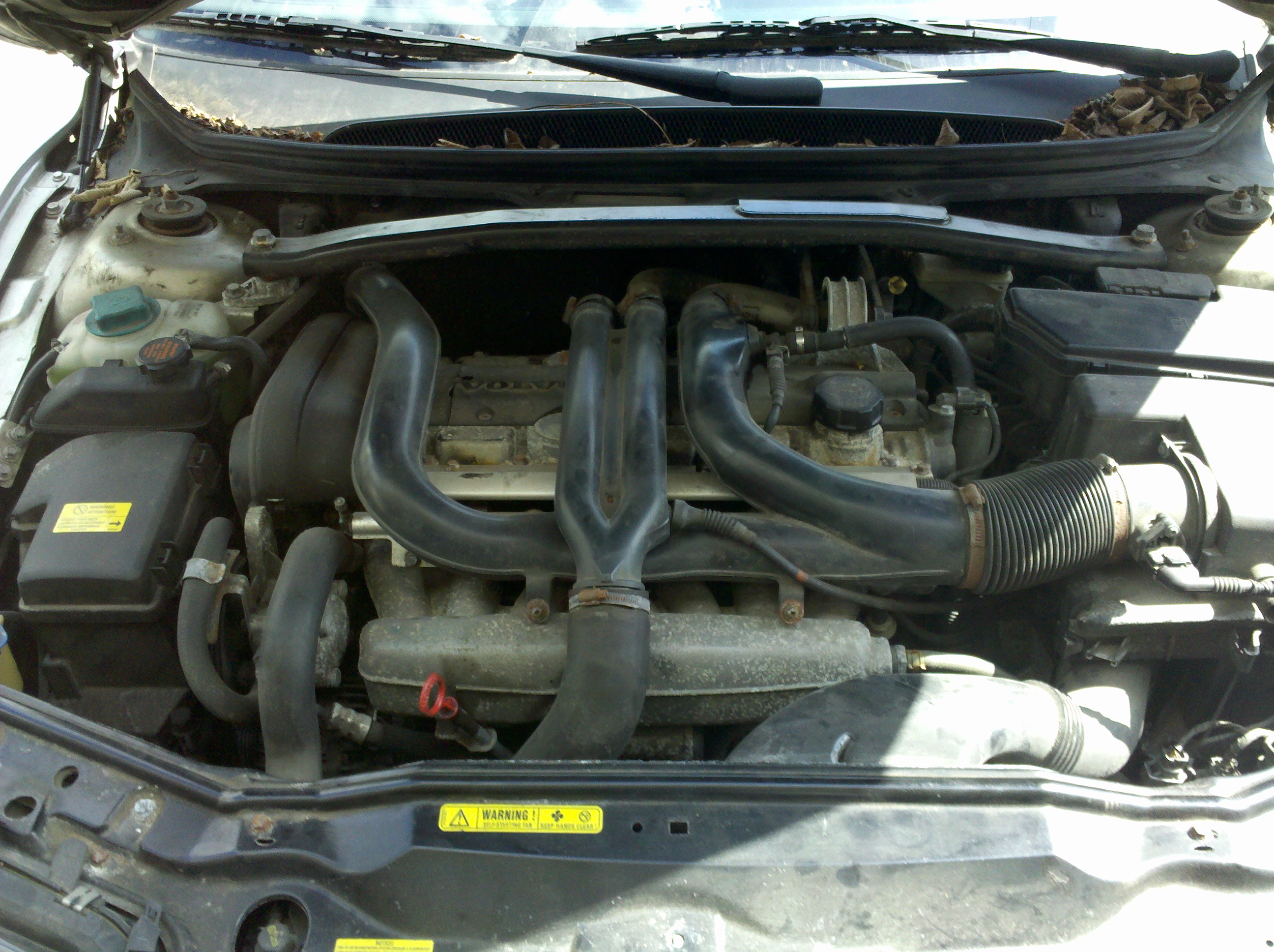

This is my new s80 t6 as it sits... still need tips and advice to get to Stage 0.. (see issues above).. any help is Appreciated..
Thanks

On a P2 car I'd advise against unplugging an sensor while the motor is running and or ignition is on. Is it throwing any misfire codes now? Smoke/rich running with the MAF disconnected is not too unusual.
Since you fixed a leak of some description I think at this point I'd reconnect the MAF sensor disconnect the battery to clear the codes as well as the adaptation data to start from a clean slate and go from there. Also while the battery is disconnected I would at least look at the condition of the spark plugs to see if they are carbon fouled. You can replace them with cheap copper plugs and expect to get 15K miles or so out of them. Ensure the gap is set to .028" when installing the plugs.
My theory is that your leak has probably thrown quite a few parameters for a loop and fouled the plugs with an overly rich mixture. You may well have issues with the MAP and or MAF sensors but at this point I think I would reset the codes and adaptation, use a fresh set of plugs and go from there.

Thanks for the tips and advice boosted5cyl, to clear up a few things I unplugged the MAF only for a few seconds to see is there was a change in idle.. It did cause the idle to get worse. I plugged it back in before the test drive. The leak in question turned out to be a low pressure power steering hose clamp at the pump. It leaked all of the fluid down and around the alternator and made its way under the motor. Any tips on cleaning the alternator and belt drive components without damaging electronics?? I want to degrease and power wash the whole engine compartment, it needs it as you can see. Lol
I had plugs on my list but I want to go with a good plug if I’m going to do it. , If copper is the cheap option what would be the best High and MId option for plugs? While I’m at it Ill try to do a little spring cleaning on hoses, clamps and etc.
