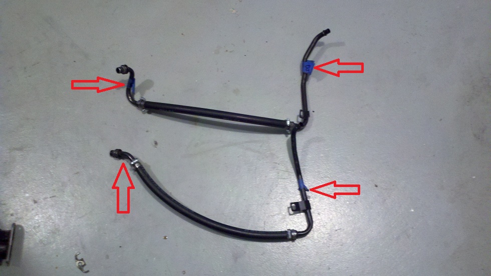

I have successfully repaired my leaking oil cooler lines all for about $25.00. The local parts store wanted about $215 for new Dorman lines. The local hydraulics shop quoted me $140 for new lines with new crimped ends. I decided why not choose DIY and save a few bucks. Here are a few steps and pictures that I gathered through the process. Extremely hard to use camera when my hands, gloves, and arms were constantly covered in leaked oil and grime but I snapped a few. I do need to give thanks and credit to RSPI and his instructions. I also used a powerpoint that I found on this website but cannot locate it to give credit so I will not publish it. I was already pretty familiar with the location of the components after the motor rebuild but it was helpful to have the pictures and to see different approaches to it.
I started by removing the bolt that holds the braces on the lines. I then disconnected the lines from the radiator. Then removed the thermostat from the bottom of the block with the lines attached. Pulled the lines out from underneath and slid the thermostat toward the oil filter and dropped everything right out. I recommend snapping a picture here to see the angles and what not on the lines and how they fit inside the car and thermostat as well as label the metal fittings to ensure they do not get mixed up. I then used the 30 torx bit to remove hoses from thermostat. I used a vice and placed a line in it and just finger tightened. I grabbed the Dremel and went to work on these lines.

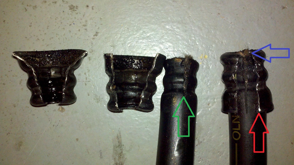

I started cutting very carefully at the blue arrow, the bottom of the line, and I cut toward the red arrow. At the red arrow I would not risk cutting all the way to lip of the fitting. I would leave about 1/16th of an inch and just a large flat head to "pop" the fitting loose. Cut it carefully and you will not hit the fitting on the metal line, there is rubber hose that helps with this giving off smoke and smell when you hit it to let you know you are through the crimp fitting. The green arrow displays this.
Once all crimped fittings were removed I cleaned up all of my metal fittings ensuring nothing foreign remained in the metal tubes. I obtained 4 feet of hydraulic hose (1/2 inch inner diameter) that can withstand the oil pressure and temp from a parts store for about $6 a foot. The job can be completed with just 3 feet. The hose that connects to the bottom of the radiator (left on thermostat) was cut to 15 inches, the hose to the top of the radiator (right on thermostat) to 17 inches. The ends were then placed into the hose and double clamped with hose clamps.

Here are the completed hoses. I threaded the hoses from the bottom of the car up. Then ends were wrapped in plastic to keep foreign objects from entering the lines. I then attached the lines to the thermostat because it was a little easier to reach the 30 torx bolt with a small 1/4 inch socket and small drive. The thermostat was then connected to the motor and the lines back to the right side of the radiator. Started her up and let her run for a good 20 minutes to ensure no leaks were present and ran her around town. Shes in the garage tonight with cardboard underneath it to locate any drops that may occur overnight. Hope this helps. Any questions or comments welcome.
