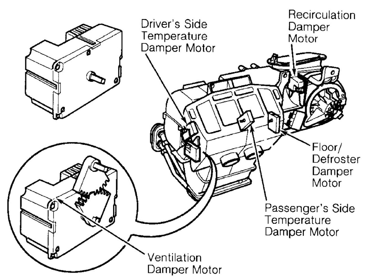

First place that I would look is at the plastic damper flap shaft where it connects to the damper motor.
Sometimes the plastic cracks and can be repaired. You should be able to reach it from the glove box cavity.
This image is from an 850 writeup, but the servo motor locations are the same through '00:
