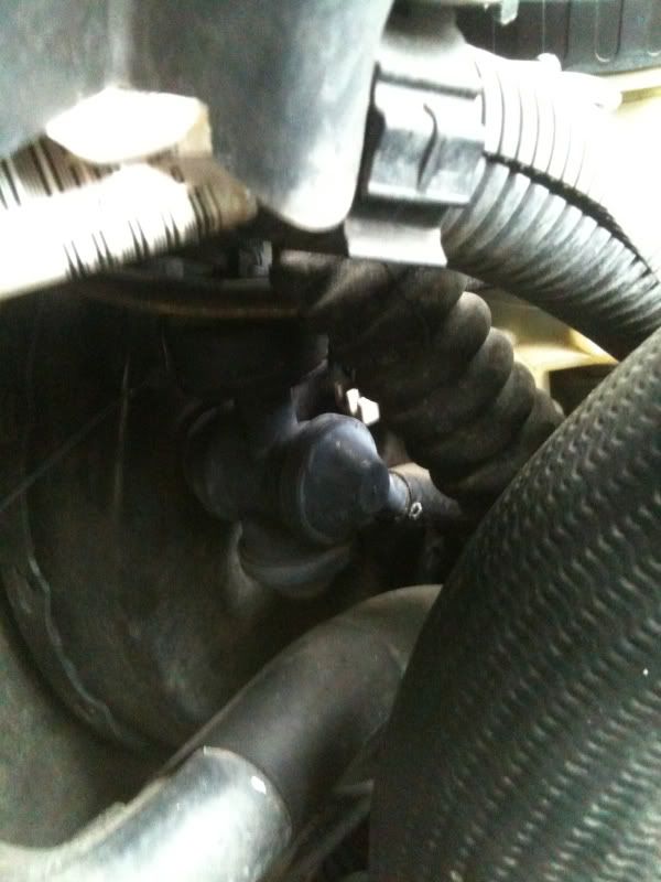

Found a vacuum (attached to the brake booster) whose plactic clips had broken off and was pushed off by a spring. Tied it back with a couple zip ties, the abs light went off for a bit, but returned later on, my guess is this part needs to be replaced since when you start the car in the morning the pedal is stiff and barely applies brake, till it warms up and I guess the vacuum works, then its normal braking for the rest of the day.

The CVVT changes the cam timing for cold starts and the change results in almost no manifold vaccum for a couple of minutes. Thus the need for vacuum pump. Sounds like you are describing the vac pump switch.

This is the part (right at the brake booster)
And this is the "lid" that had the broken tabs
