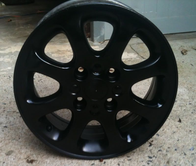

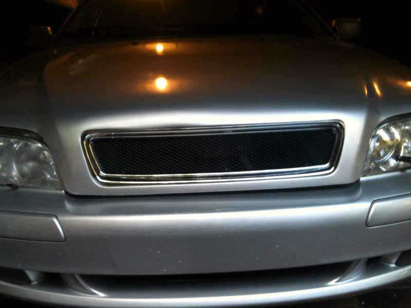

Although Im working on the mechanical part of the car, I also got some goodies.
The grille was all broken up so I got this replacement for less than $60.00 with shipping (I was looking for an used one to modify, but found none local)
Also found a set of wheels for $175.00 and after some black paint...
I think they look much better in black than the actual wheels on the car
