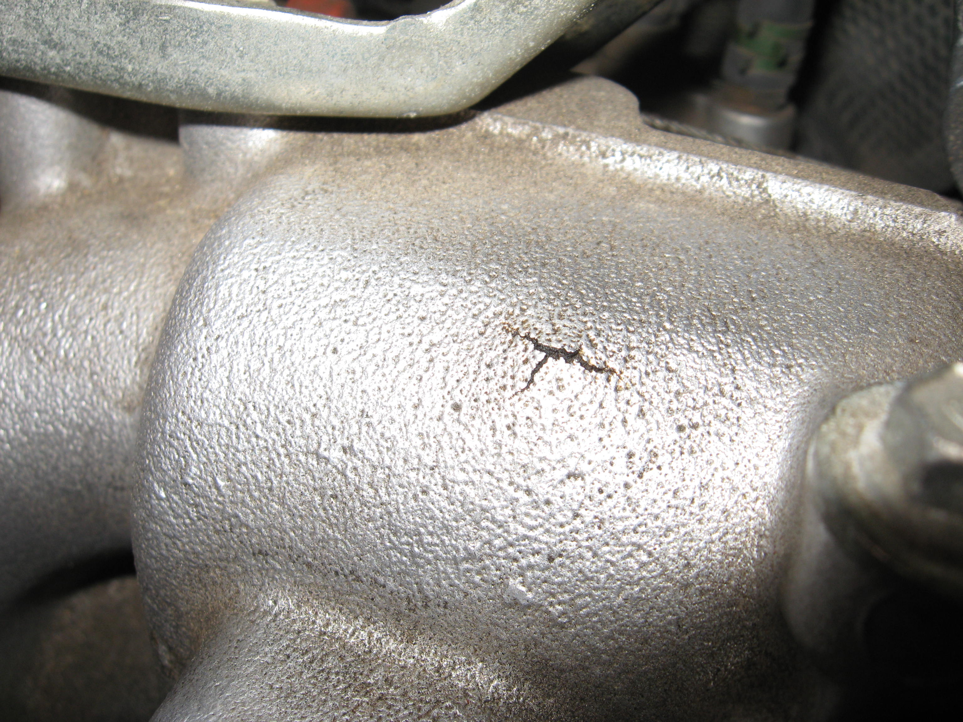

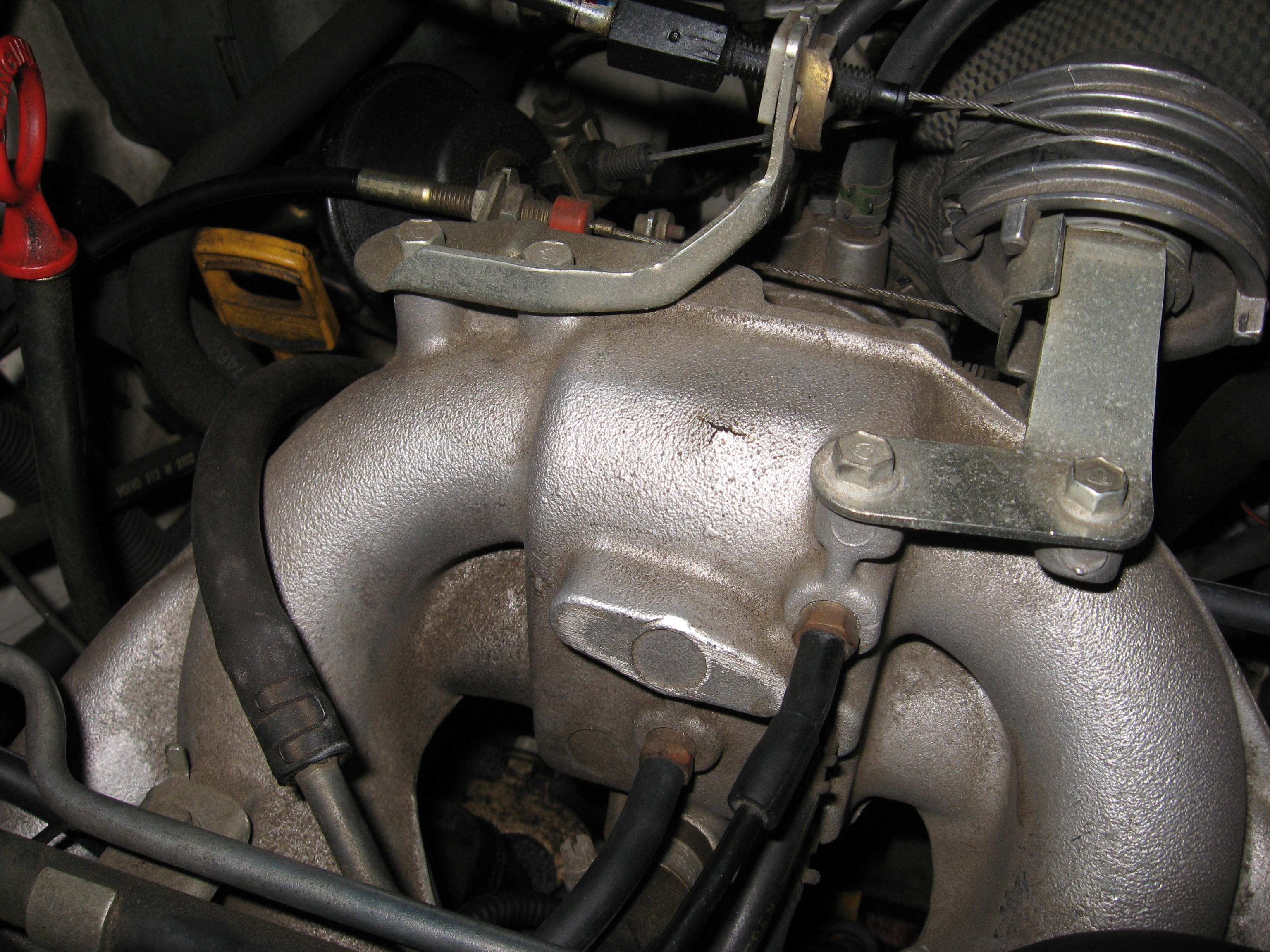

Yes actually about 3 or 4 years ago maybe less, it was one of the first things I did a while back when I had a different issue with cold start rough idle problems. There is one thing that has bugged me though and I have attached some photos. The bump on the intake manifold somehow from the inside? That has been there since I bought the car. The car was dealer serviced until the magic number for everything serviced on the car went over $1500 per visit so that stopped about 15 years ago. I have managed pretty well since then but as we both age the issues become more complex? I forget what I had for breakfast and the car forgets it's supposed to get me there.

The crack from the inside out is a new one on me. No residue of oil so it isn't leaking.

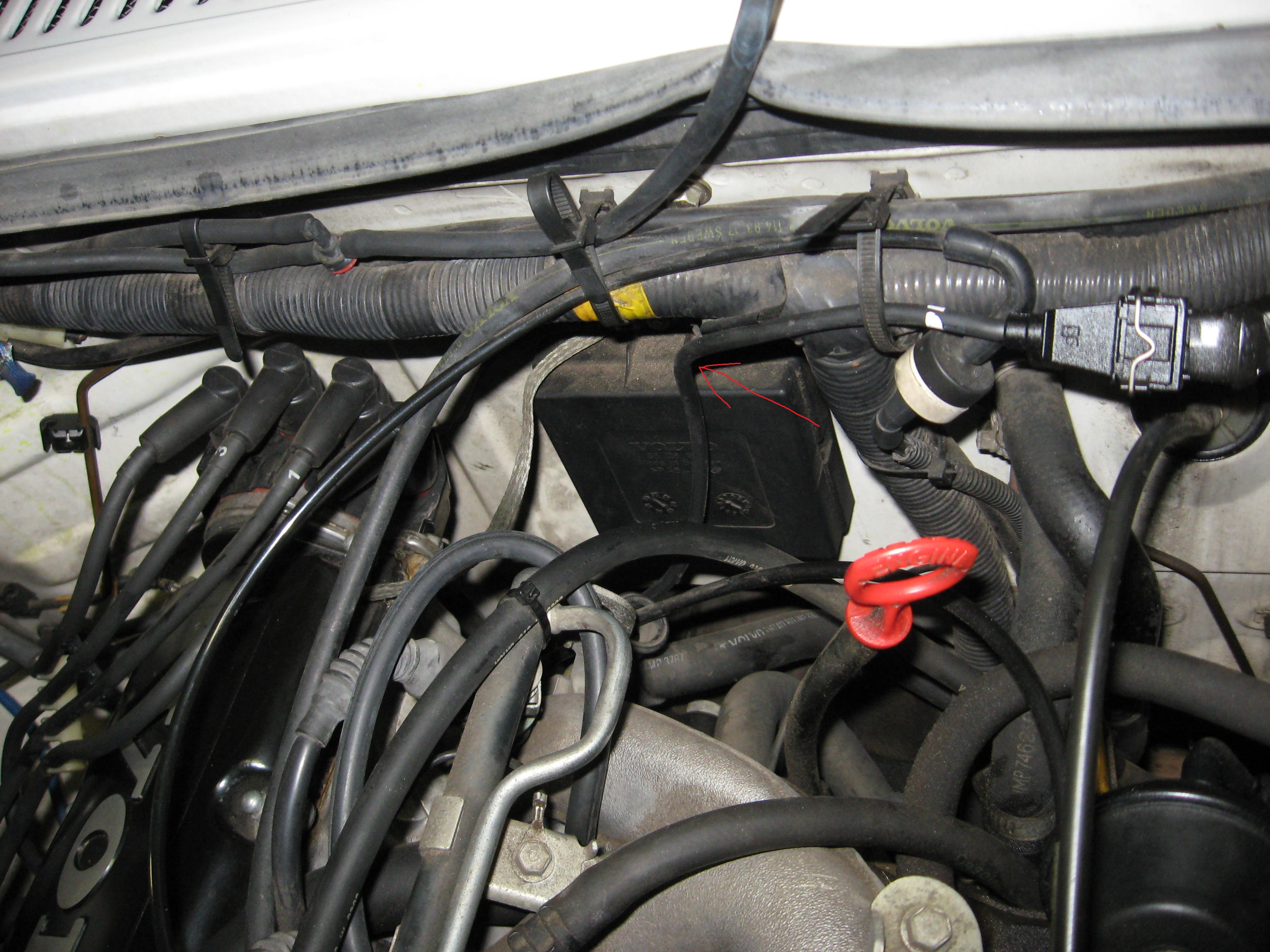

[quote="Volvo1man"] but have you checked or replaced the RPM sensor? It is located at the rear of the engine, on the bell housing. quote]
If this is the guy(feeble red arrow) then it is in fine shape. It is the only cable I found going into the bell housing at the rear of the compartment. Also it passed the proper codes in Diagnostic 2 for testing the sensor 1-4-1.

jimmy57 wrote:The crack from the inside out is a new one on me. No residue of oil so it isn't leaking.
I love being unique.

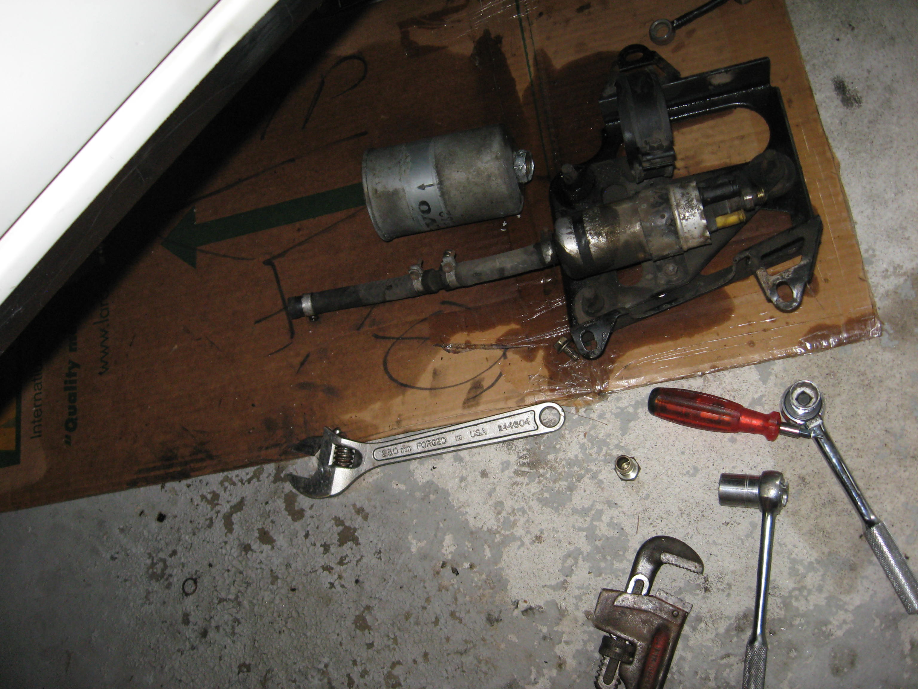

Simple my ass. What a nightmare, what should have taken a half hour took two.I recommend dropping the assembly if you have never replaced the filter before because the fittings were quite a challenge. Also a small container as it drained about 3/4 to a quart of fuel. I PB'd the hell out of them and still munged up one side slightly damaging the tubing. (photo attached of damage and repair). I will need to replace the high pressure pump because it is not working(recommendations welcomed). I used a Purolator filter F64857 $27.99 at Pep Boys, I know the FCP price on the Bosch was $17 and change but I wanted to try and fix before the weekend. I will order a pump and short fitting as well as vacuum fuel regulator because nothing really changed. It runs slightly better(15 to 18 yr old fuel filter) but still is erratic above idle. If nothing else I hope it is a good tutorial on filter/ fuel pump replacement.

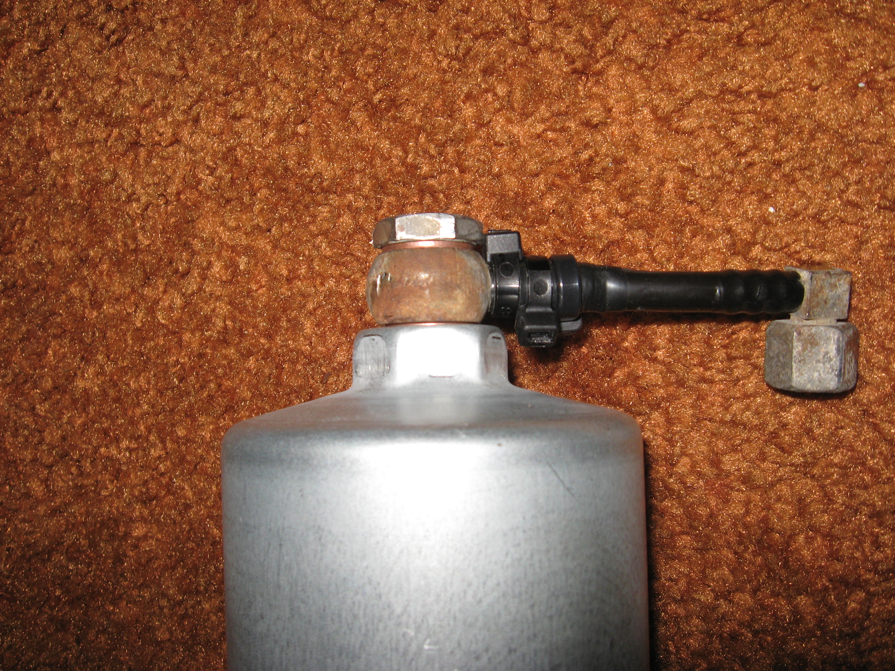

repair of damage, punctured tubing on nipple when wrench slipped and destroyed filter and knuckle. I wrapped with vinyl electrical tape first.You can use 19mm or 3/4 wrench for the fitting. The compression fitting from pump on right is 18mm. I love tie-wraps-zip ties, zap its whatever.
you can see the damage on the old filter. I ended up using the pipe wrench to get it off.
