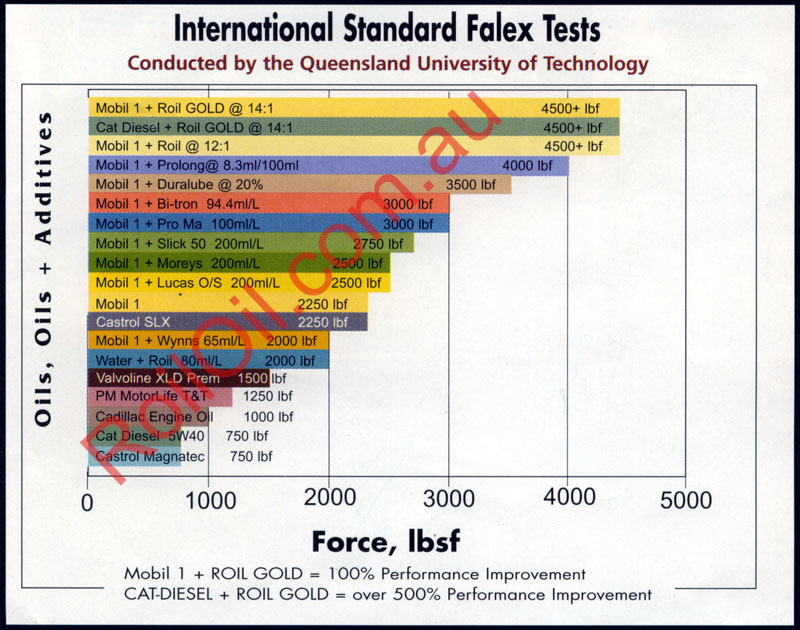

You won't find a single solitary person to back me up on this forum :D I'm in virgin territory here. But as I understand it, cars' engines are not too disimilar and respond the same way. Volvo never intended for our crankcases to be gummed up with years of sludge. This 3 part system can clean the crankcase & fuel system and then friction modify the metals so less throttle is used for a desired output. Emissions are naturally lower.
It's the first time I mentioned it with a full explanation.
Do your own research. As I understand it emissions testing takes considerable time and expense by being away from your employment. I've seen afew guys make some changes and pass through and quite afew others give up and sell the car.
Have your O2 sensors replaced if needed. Also how's the PCV?
Canada Neways can provide you with distributor details for purchase. http://www.neways.com/ca-en-ca/content1.aspx?pageid=113
