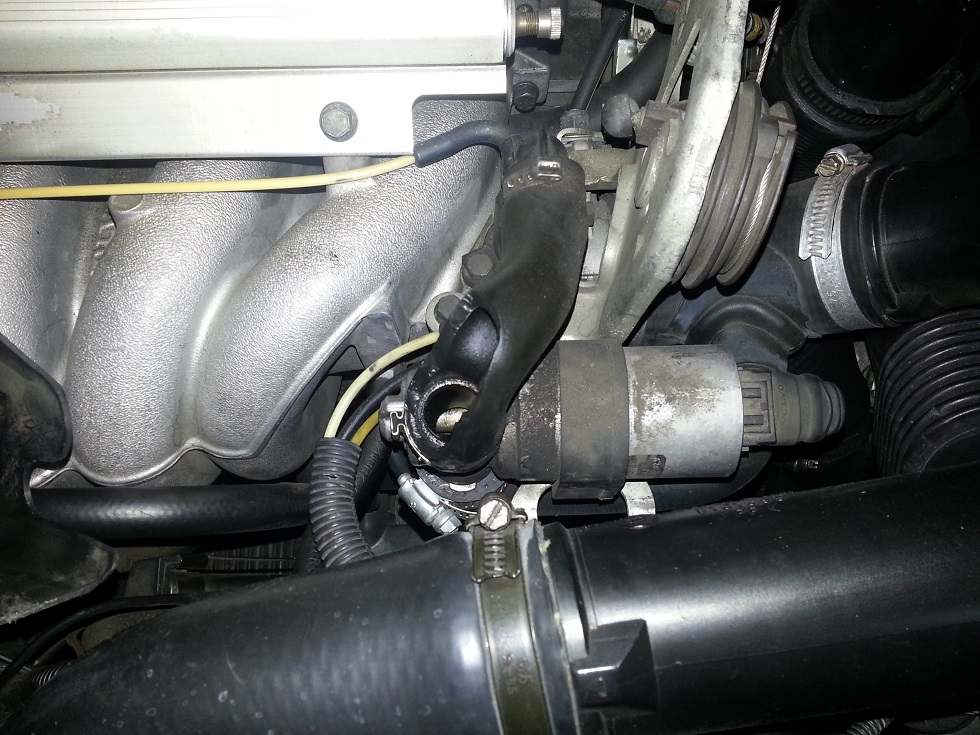

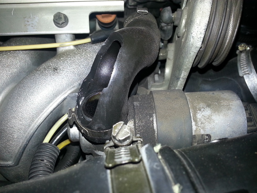

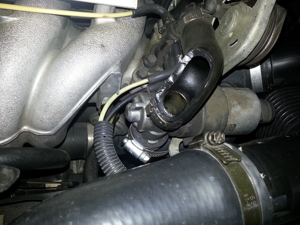

I have had these very same symptoms. Car is not driveable now and has benn sitting in the garage for a while until I can figure out what to do and/or save money to fix. When I parked it the first thing I though it could be was teh idle control valve, since my idle was sporadic and stalling. I did take pictures of what I found. So, when I popped the hood and then took the cover off I found that the hose had either been cut or sheared off. I'm not sure how this happened though.

Any thoughts?

DrewsT5 wrote:I have had these very same symptoms. Car is not driveable now and has benn sitting in the garage for a while until I can figure out what to do and/or save money to fix. When I parked it the first thing I though it could be was teh idle control valve, since my idle was sporadic and stalling. I did take pictures of what I found. So, when I popped the hood and then took the cover off I found that the hose had either been cut or sheared off. I'm not sure how this happened though.

That's a hugemous air leak. Fix that hose and your car will probably run.
I have no idea how that happened.

No doubt about that. I'll price one at my local stealership for fast pickup, or order one online. Any idea as to how something like this could happen?
Posts: 35272
Has thanked: 1497 times
Been thanked: 3810 times
Swedish rats. Everyone has Norway rats, but Swedish rats ate your hose.

Check the inside of your throttle cover for a razor blade. That is unbelievable, and was cut and not worn. Yes, that will keep the car from running...
