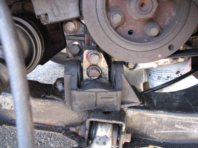

That explanation of symptoms has all the indications of the lower right engine mount by the crank pulley. It is an inexpensive piece and less than an hour of simple work. It is pictuerd in my avatar photo.
There are write-ups in the repair forums.
Here is a comparison of the colapsed one and a new one. I would not suggest jacking up the engine by the oil pan as a test.
If it has never been changed it is likely shot.
Good luck.
Good luck.

thanks for the reply/photo's. I just assumed that if the mount was broken then there would be a large separation when jacking up the engine...is this not so? I only raised it a small amount and didn't notice any gaps. When looking at the mount from underneath it appears to be full....kind of like a balloon...I thought they were full of some kind of "shocking" liquid and if broken would not appear the way it does.

No, you will not "see" the separation, but you will feel it because the engine will effectively be sitting on the subframe. This is a solid rubber between metal. There is a safety bar that is not seen that does not allow total separation.tomstir wrote:Ben,

I switched out the tie rod and took it for a spin around the block....did not hear the annoying sound anymore.....I will drive further tomorow (my baby was sleeping and I didn't want to go very far) to check it our for sure. While in there I looked the mount below the crank pulley and it looks fine. I hope this fixed it!!
I'm still not sure why/how the sound was being made...if it was the joint....I moved it around once out and could not get it to make any sound other than some of the grease escaping from the boot.....maybe I can't mimic 1000 pounds of force with my hands.

If it was the engine mount (which looks fine) wouldn't the noise be made at idle? Or at least when revving the engine..wouldn't the engine shake or vibrate more than usual? I would think the engine would lean more to the passenger side too?
