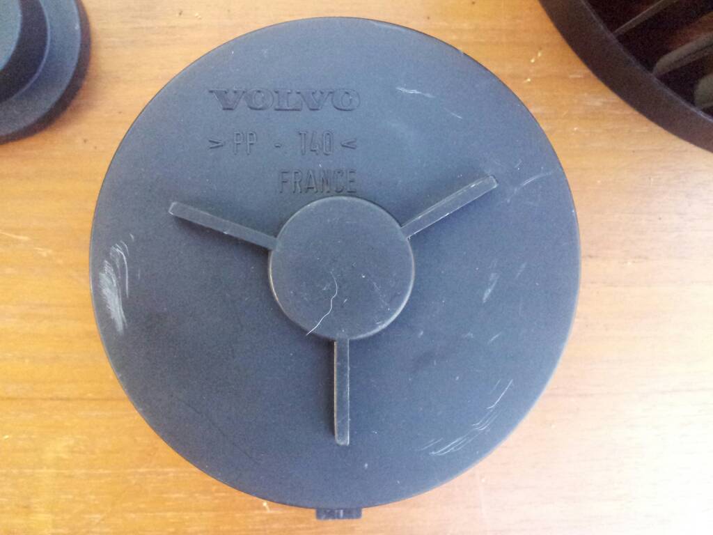

Don't know if it's visible in the photo but can you see the words Delco Products USA and Valeo further down as well as Volvo France written on the outer plastic motor casing. This is an original motor from a '99 V70..... this thing is such a mongrel.
