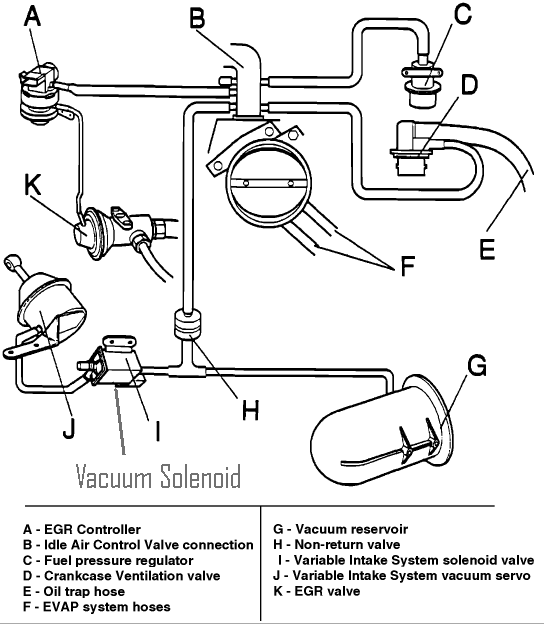

Your '93 has what is called the VVIS intake manifold. There is a black plastic vacuum line that goes to an actuator under the manifold. It connects to a "T" check-valve which splits to a solenoid on the airbox, and a vacuum tank under the fender.
If that is unhooked there will be a vacuum leak drawing from the manifold junction. It will cause eratic behavior if it is unhooked.
Here is the vacuum diagram.

To be clear, the solenoid " I " is mounted on the airbox under the distributor cap area. It has a slightly larger than normal black plasic vacuum line running from it to the front of the engine, under the manifold to the servo " J ". The vacuum tank " G " is in the front fender, under the battery area, in front of the EVAP canister.
If this is hooked up correctly and functioning, you should feel strong accelleration whenever you reach around 4,100 RPM.
Good Luck.

Thanks for the diagram and the detailed explanation. I found the big black plastic line that runs under the manifold and that's connected. I also checked the other vacuum lines listed in the diagram and it looks like they are all connected. I haven't had too much time so I'll double check them this weekend. The line I found that's not connected to anything shows up just under the battery tray and runs under the cooling fan and disappears under the alternator. I haven't been able to get under the car to see where it ties into. I attached a picture. Thanks for the help so far.
Good Luck.
So there was a vacuum leak to say the least. I had check all the lines under the hood but never checked under the front fender where the canister and reservoir are. Well i did not have the canister nor the reservoir. So i went to a yard and picked one up and attached it with all the lines. I followed the diagram under my hood but I don't think I did it right cuz the car still jumpy. The one I pulled from the yard had the line from the non return valve running into the canister but the diagram under the hood shows it runs into the reservoir. Anyone have any suggestions
