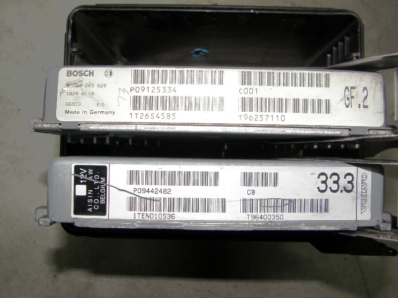

ECU tweaked by IPD. It does the job!

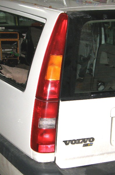

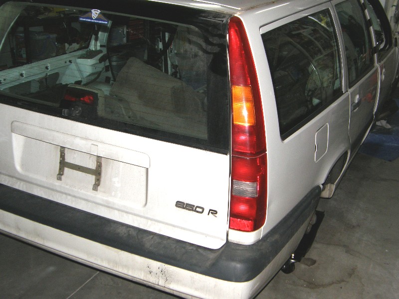

2 perfect tail light assys, left and right as well as top and botton.

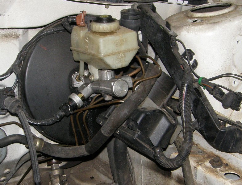

Rebuilt Master Brake cylinder with TRACS and ABS (ABS recently redone by MattyMoo. Perfect now!

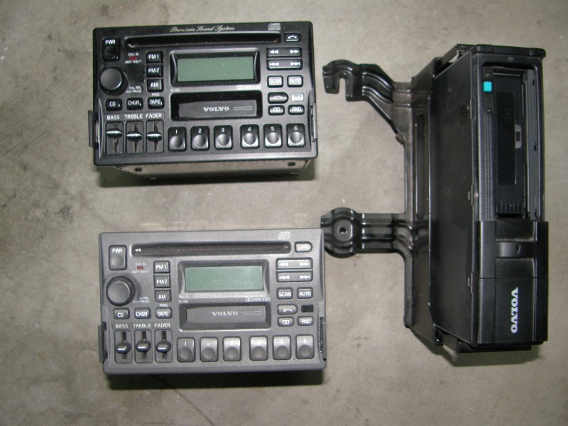

2 SC-816 Radios (top of the line back then) and a 6 disk changer.

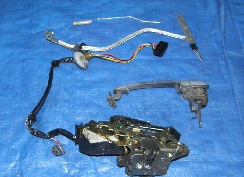

Right-hand (Passenger) door lock assembly, complete with all parts
