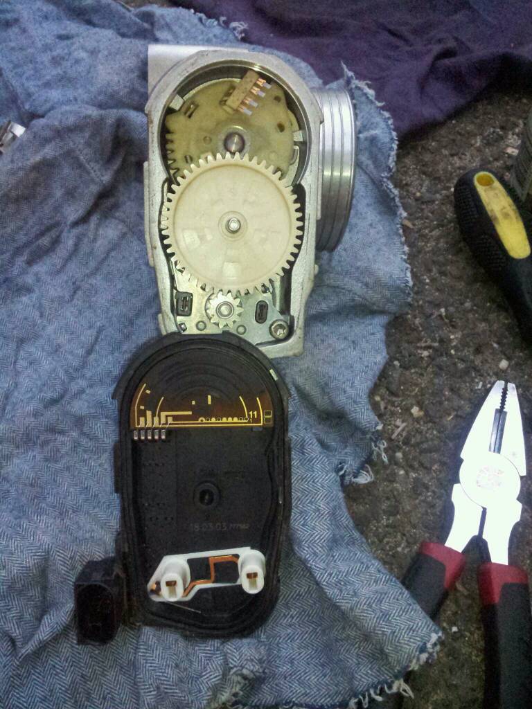

Vida says to adapt new Bosch throttle body clear all codes connect new unit and turn on ignition. No software. Just had one apart today for a customer. Try cleaning the resistance film and retensioning the contact brushes.
- uploadfromtaptalk1360715528060.jpg (120 KiB) Viewed 3866 times
