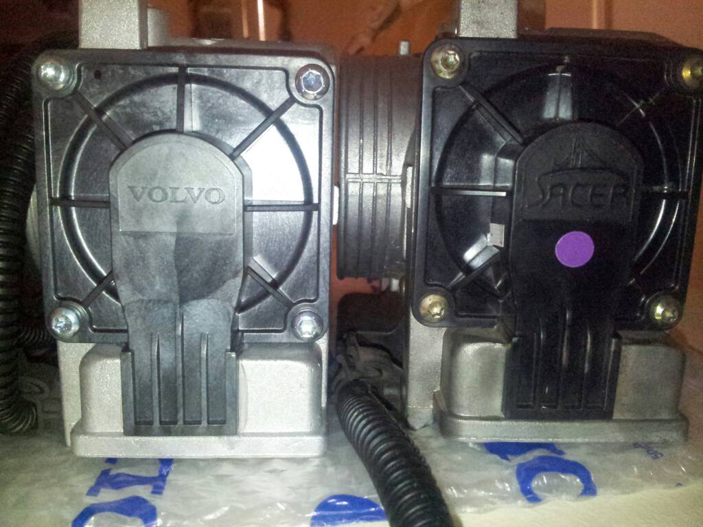

Just got a new (rebuilt) Volvo throttle body from FCP today for a customer. Lo and behold it has a new contactless sensor in the exact shape as a Sacer sensor with a Volvo logo on it;These have new boards on them and require initialising by a dealer. Seems a very good investment in my opinion for $459. Once this gets out FCP will be getting orders by the bucketload. Only issue is that the car requires either a dealer or an indie with an Autologic scanner or Autoland Vedis II or iScanII to start it up.
The photo above is what a film type (Magnetti Marelli) endcap looks like. Below are the new Volvo and Sacer endcaps.
- uploadfromtaptalk1361969303487.jpg (99.22 KiB) Viewed 2222 times

I have similar symptoms, but I get a PO121 Code; Throttle/pedal Position sensor/switch"A" circuit range/performance problem.
I got a Sacer TPS sensor cap after limping home, and installed it very carefully. Erased the codes, started up, same result, limp mode, 2K rpm max, PO121. Are there tests to see if the ETM is working while still in limp mode? Are there any tests for checking viability of ETM after removal from engine? I'm stalled as to my next step. Can I test my Sacer install, it looks really good to me.

Did you voltage match the rear sensor to the front sensor by slightly rotating the magnet? Voltage is taken on pins 1 & 3 of the new sensor and pins 2 & 4 of the old sensor's contacts.
Did you properly disconnect the old Magnetti Marelli sensor on pin 2 & replace the rear sensor's output?
Does the rear (old sensor which is still attached?) even have voltage?
Rig up a test system using green (+) and brown (-) for power to the unit and test outputs.
