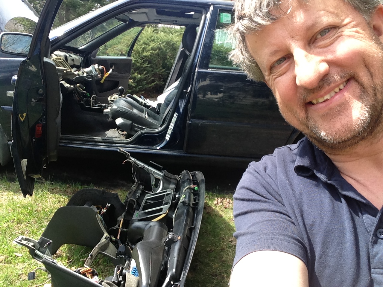

My heater core finally went from seep to leak so I'm diving into the major dashboard removal on my wagon and replacing both heater core and AC evap.
I don't see a good document on this so I will try to remedy this.
The VIDA documents are nice procedures and are in this thread ,...
https://www.matthewsvolvosite.com/forums ... =1&t=55395
I am still trying to source the tool to release the heater hose clips btw.
1999 V70T5M56 AC evap 9171781 and heater core 9144221 replacement (Pics end of thread)

OK - I think Im beating the clock on this one. 2 1/2 hours working time.
There were two Torx screws not on the VIDA document that I caught, in addition the electrical disconnects werent well documented. Ill certainly write this up since that will help others.
Im a decent mechanic, not expert, but not novice either. Hope this will encourage others not to fear dashboard removal. I actually got it out solo, but I recommend a helper for moving it out of the car.
