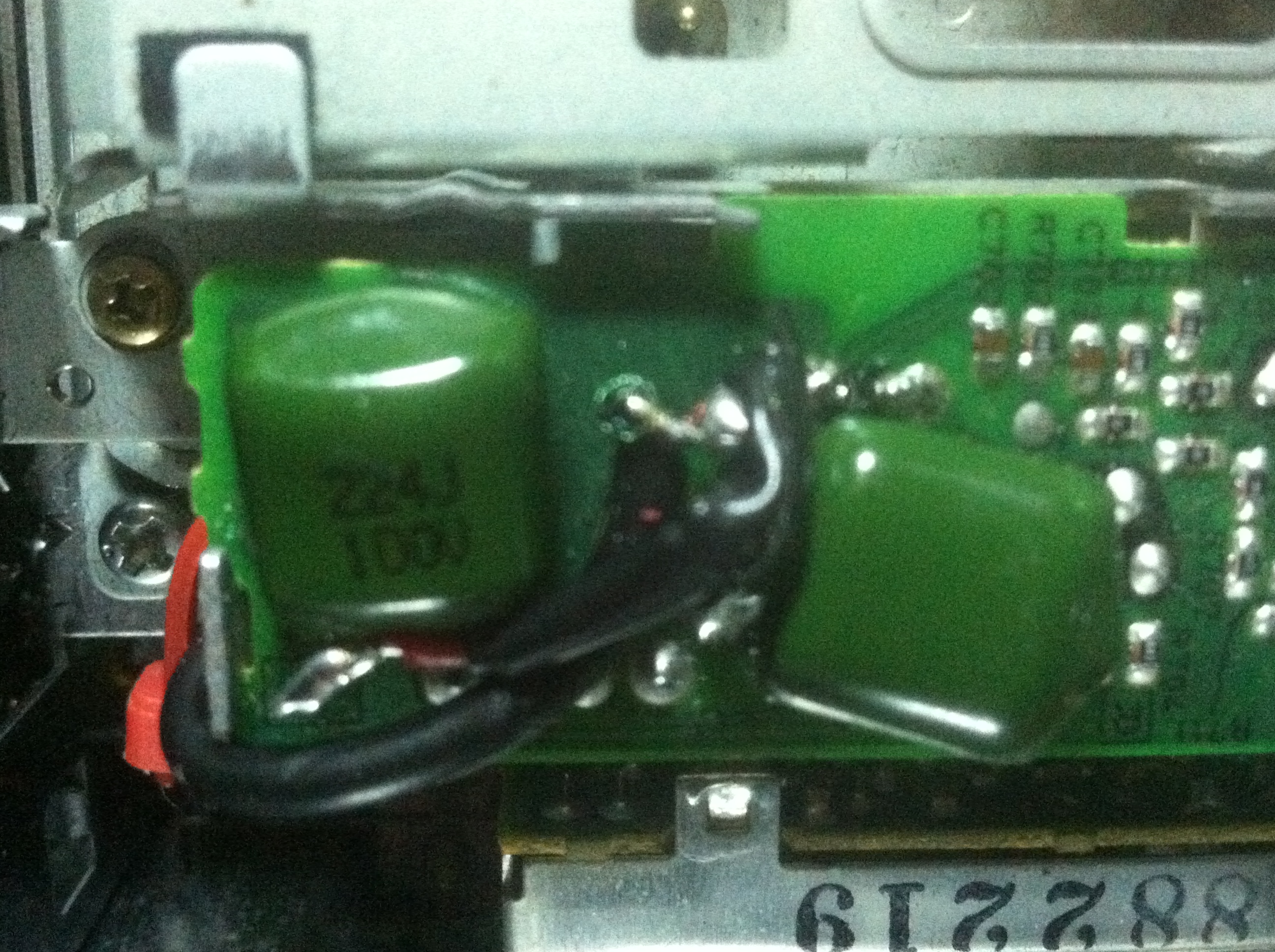

Solder the caps to the R ch and L ch, to the board if you can. If not, I'd recommend using and electrolytic cap and a wire lead, easier to solder into the printed circuit board. My usual trip to RatShack ended up using polyester film caps, somewhere in the 0.1 micro farad range. Increasing the capacitance a slight bit (roughly a 1000 uf cap would be quite small yet more effective)... Also, from my car audio days of my youth, electrolytic caps are what I used for regulating current and high pass filtering. The caps I used still have a greater volume than say, the radio, or tape adapter with variable volume (my CD player stopped working, it's a dead media to me anyway). The main problem with the insane amount of speaker-killing bass is not an issue anymore.

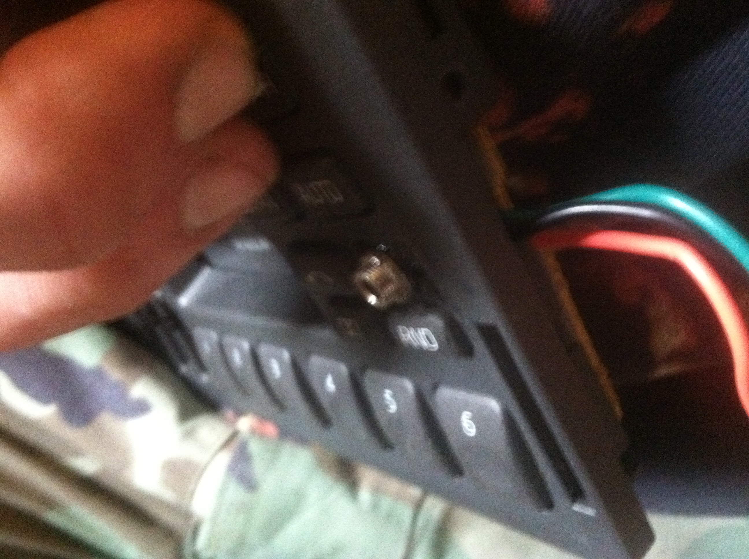

Cut out a spot in the existing IR sensor hole for a 3.5mm jack. Install went pretty well, aside from bending and breaking some terminals for ease of installation and soldering directly to the cable contacts. My ground lug was the only lug left, bent parallel to the jack body. Fits great. Personally used an x-acto and some wood carving knives to achieve a clean mounting point. I used superglue to hold it in place. After the first jack snapped (this is why I suggest ripping the IR sensor out), I was a bit overzealous with the glue. Again, character. Whatever you feel comfortable using, the plastic material is pretty easy to work with using a good, sharp x-acto.

Solder to the pre-amp channel points as shown in the cross-referenced forum. My pic was a bit messy yet used the same solder points.

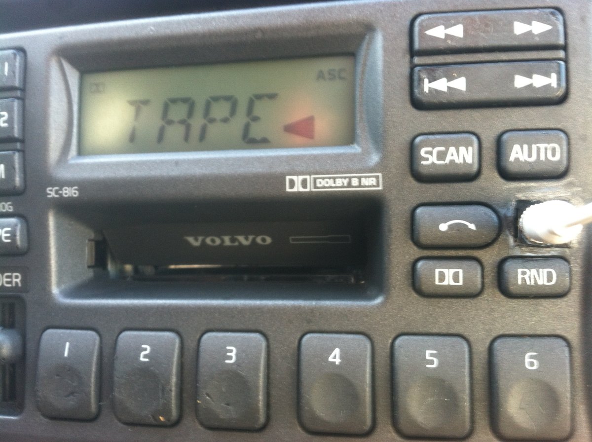

Reassemble.

The caps soldered in place from an earlier version of this now complete project.
jack installed from the front.
