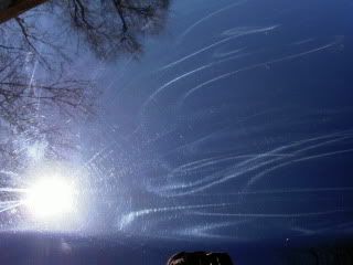

I used MUC on the sled a few years back. She'd never been compounded before. Regularly hand washed, then clayed, then a coat of NuFinish. Which worked well for protection but not much for shine or gloss. Then again, a white wagon has no depth really. There were numerous swirls/fine scratches in the clear coat.
Turns out a neighbor had a FLEX and kindly let me borrow it. I bought fresh pads, UC and went to work. Took most of a day if I recall. Due to the recommendations for Dura-Gloss, I went with it. Finally found it locally after quite a search. Easy on & off + doesn't stain black trim like NF does. It also really shines up a white "floor freezer on wheels". I was rather amazed.
I don't think I would have gotten NEAR the results though without the FLEX or equiv. There's a LOT to be said for using such a machine.
