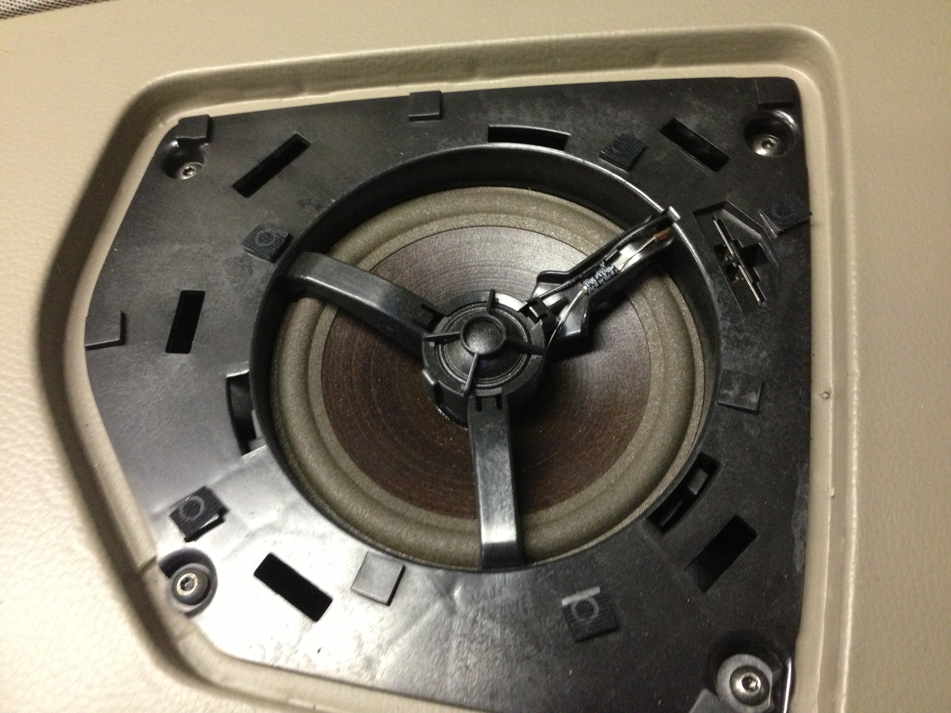

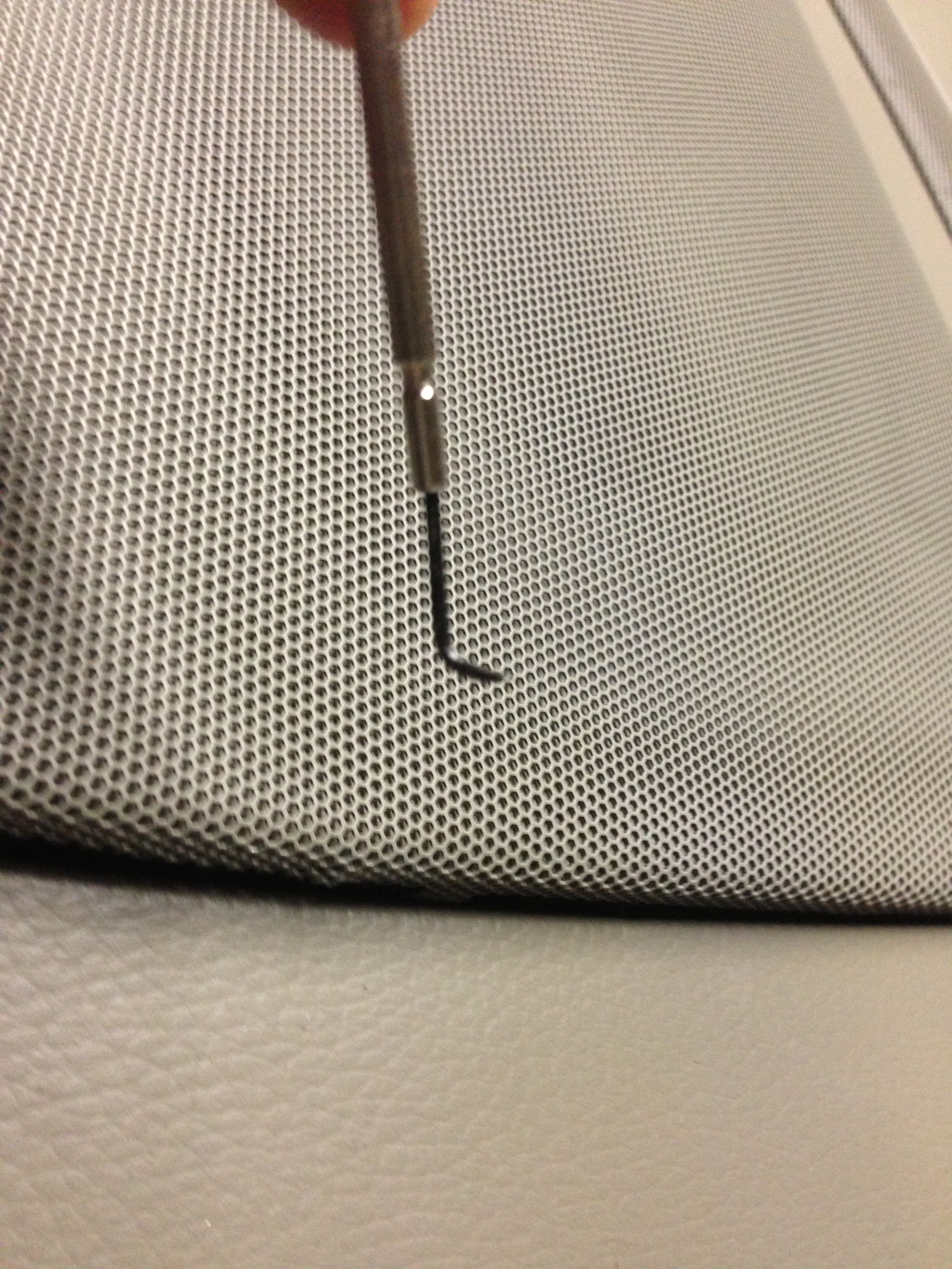

1. Find a old micro flat head screw driver and bend 90 degrees to make your pulling tool. (see image 1)

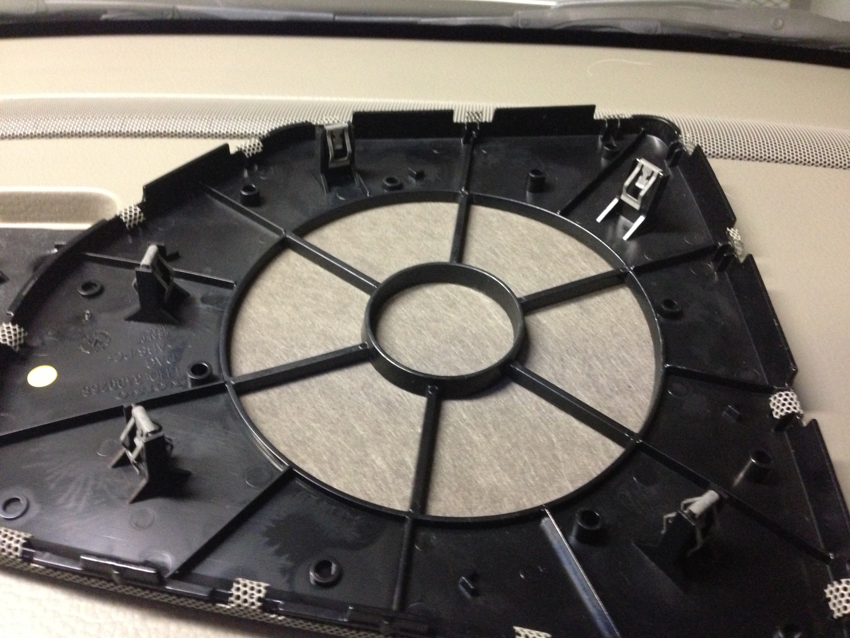

2. Push the tool into the crack and rotate so the bent portion is pointed towards the speaker. (see image 2 and 3 to see where I inserted the tool)
3. Make sure you get the tool deep enough in order to catch the black plastic. (see image 5 for an idea of how the plastic and grill are attached together)
4. Pull up very hard. There are 5 clips that hold this grill on (see picture 5) and it tool a lot of pressure to get to to come out. When pulling, pull straight up.
5. Once it pops out there are 4 T25 torx screws to remove. I chose to use a 1/4" ratchet with a T25 bit as getting a screw driver against the glass would be difficult.
Image 4 is what the speaker looks like with the grill removed.
