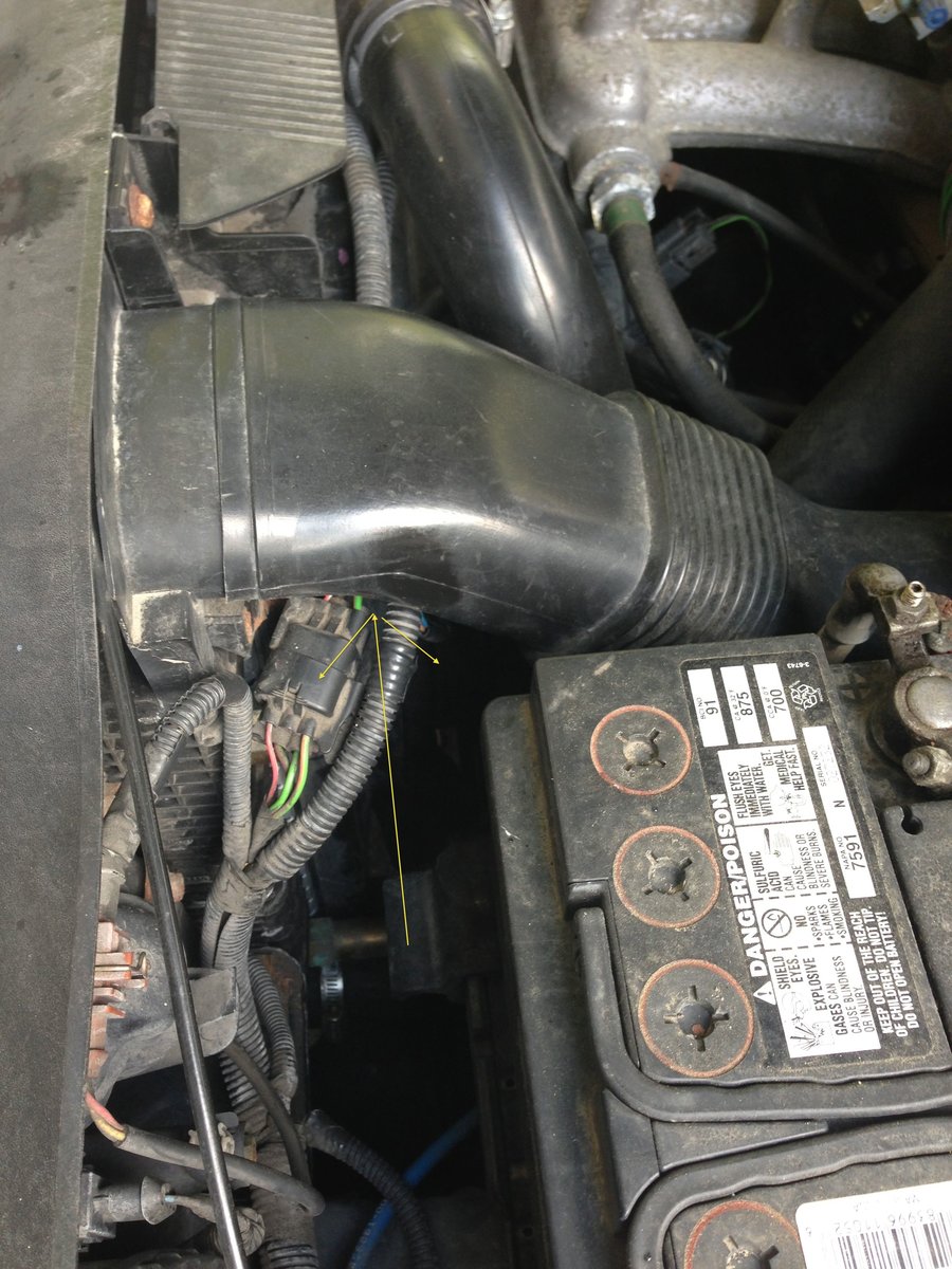

Hmm...try one other thing. There's a vacuum line from the purge valve into the intake manifold. Next time it's cool again, take it off and tape both ends up. See if the stutter is still there.

Radiator shroud, just in front of the battery. It should have 3 lines hooked into it - may be either a circular valve or a rectangular one.

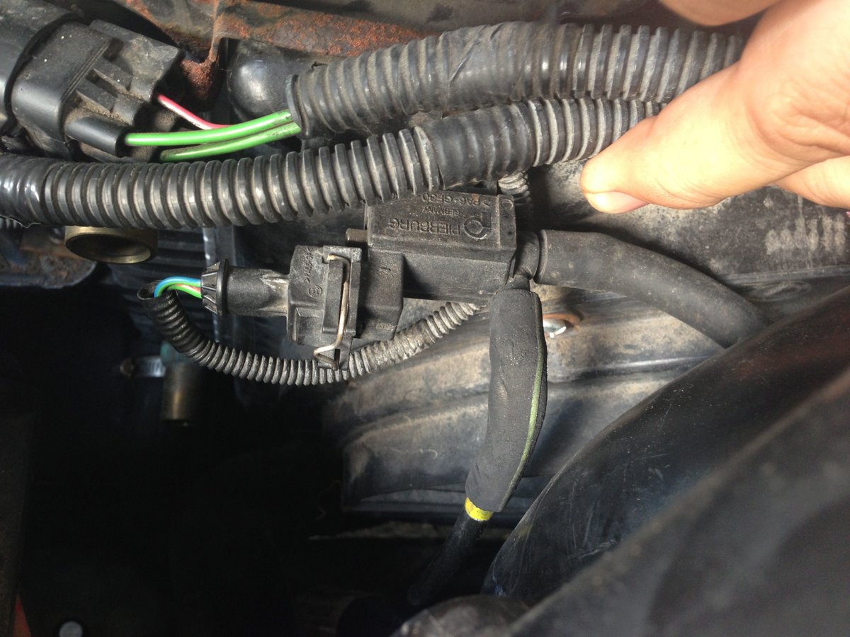

Purge valve on my 1999, hides under the air cleaner feed hose..
