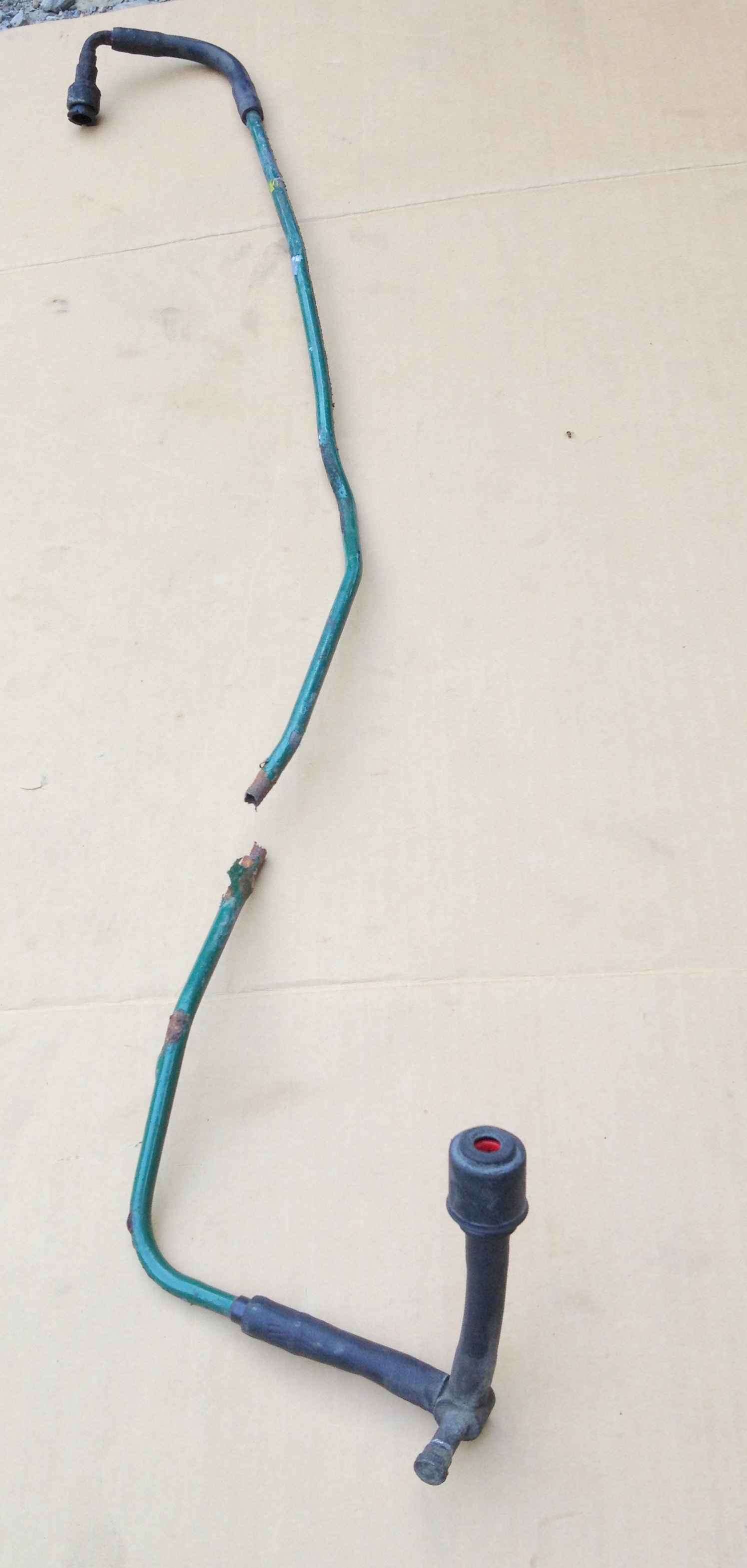

I have a leak on top of the fuel tank that only appears when the car is running, so I assume it is from one of the pressurized lines from the fuel pump. It appears to come from the top on the passenger side and runs down the outside and drips off the bottom of the tank. The car is starting a little slower than usual probably because the fuel pressure is bled off by the leak. I've not been able yet to see exactly where the leak is or which line it is.I have removed the two plates over the filter and the large tank on top of the axle (overflow tank?). I can't see any leak from there, but can see a little wetness on the tank itself. The filler pipe connection looks dry, and so do the pump cover and the lines going into the cover. I loosened the passenger side tank strap and lowered the tank a little, but still can't see far enough up on top to see the lines up there. I wasn't able to get the drivers side strap loose yet - very rusty and the socket stripped the bolt head. Tomorrow I'm going to try a borescope to see if that helps. I found a diagram of the tank that someone uploaded from Vadis, but it doesn't show how the lines run from the pump to the filter and back up front to/from the engine. If someone could tell me the exact routing of the lines around the tank and the fuel filter, and if I can isolate the leak to one or two lines, I think I might be able to snake out and replace the pressurized lines without removing the tank. The line going into the pump on the outboard side looks rusty, so I probably want to replace that line in any case. The pump itself has never been a problem.
My simplistic guess is that the outboard pressurized fuel line from the pump goes to the filter, then the line from the filter goes back across the tank to the front. However, I don't know if the line from the pump goes in the front or backside of the filter. I also would guess that the fuel return line from the engine goes across the tank to the drivers side where the sender unit is. I think there is another fuel line running from the inboard side of the pump across to the sender unit, but I don't understand its function. I read on one of the forums that the drivers side unit also is part of the pump. I really don't understand how the units on both sides function together
I have read several posts on replacing the fuel pump on the AWDs, but none of them address leaks on top of the tank. Obviously I would like to avoid removing the tank if at all possible. I'm pretty sure I can figure out how to remove line connectors at the pump and the filter. I may do the "hole cut" if I need to remove or pull up the pump to get at the connectors on that end. I read one post that suggested there might be some other "view ports" on top of the tank, but the floor above the tank seems solid to me except for 3 very small round metal inserts, maybe 2" diameter or so, underneath the seat. I took one of them out but the tank was right up against it.
Thanks for any good info, diagrams or suggestions. The car is my "backup" right now, so the fix isn't urgent, but I would like to get it going again.

There is one high pressure, the one from RH sender out to line to front of car. There are two low pressure, the one from FPR to LH sender to feed the ejector pump and the other is the line out from ejector from LH sender over top of tank to RH sender. The last line effectively has no pressure.

That's what I was thinking, or something in that general area anyway. I was just there installing a new fuel pump cartridge last week. I went ahead and cut a hole, wasn't too hard.It could be the seal beneath the big plastic nut that retains the fuel pump if fuel drips out even with the car off. That is, of course, an easy fix - once you get to it.
1998 V70XC
I got the tank lowered a couple of inches, and was able to spot a small spray on the top of the tank when I started up the car. It was hard to see in there, but the spray appeared to be coming from a rusty section of the high pressure line from the pump to the filter. In order to get it out, I needed to unhook it at the pump, so I cut an access hole with a drill and small hacksaw. The metal was easy to cut and I was worried about sparks from a grinder wheel. Anyway, I got it disconnected and pulled the line out. The line was weak at the rusty spot and broke when I tried to pull it out from the filter side. I got part of the line out from the filter side and the rest from the side of the tank. So I'm 90% sure this is it. The line is mostly steel with a couple of flexible sections at each end to the filter and pump connectors.
Question- should I try to duplicate the original line, or just go with a flexible line all the way? I'm going to look for some steel pipe; not sure I can find it.

After a lot of searching for a Volvo factory made high pressure fuel line from the pump to the filter of the 98 V70 AWD, to fix the leak described above, I finally found one at jimellisvolvoparts, part number 9161125. In case someone else runs into this problem, here's a picture of the old fuel line, broken at the rusty spot. The foreground end fits the filter, and has a valve attached. I twisted that section around a little trying to see how it was put together. The end in back is the quick-connect for the pump. The middle part of the line goes right around the top of the tank, and is the line nearest to the outer edge of the tank (passenger's side). I ordered the line rather than build it. I don't think there is room above the tank for a larger diameter rubber connector in the middle of the line. I'm a little worried about getting the line through the tight space above the tank, but will give it a try when I get the new line.
I put in a new filter and it went in without a problem. There is a small sensor just under the plate that is under the electrical connectors. I'm not sure what the sensor is (map sensor?), but the mount it was on was rusted and got broken off when I was disconnecting the line to the filter. I plan to try to re-attach it with a ziptie. I hope it is not sensitive to orientation.
