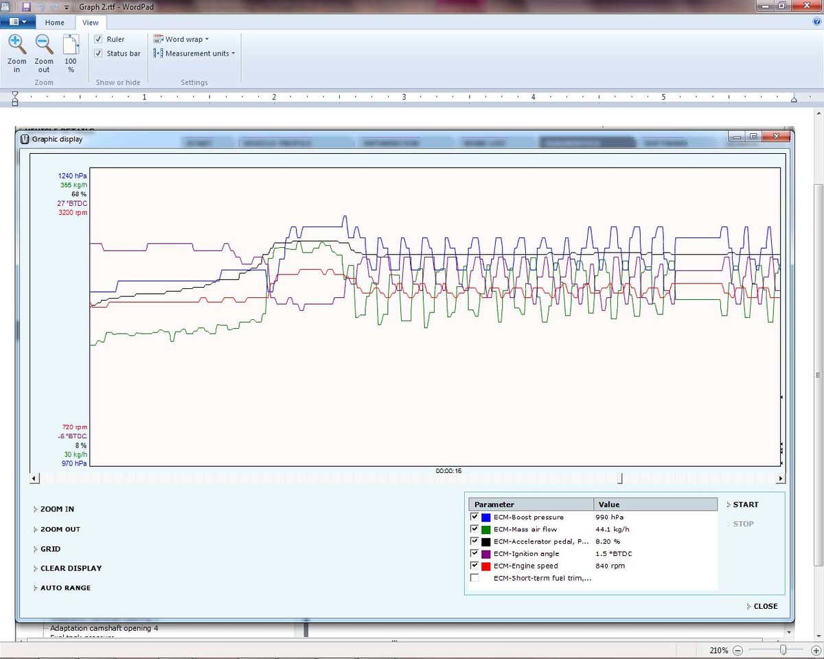

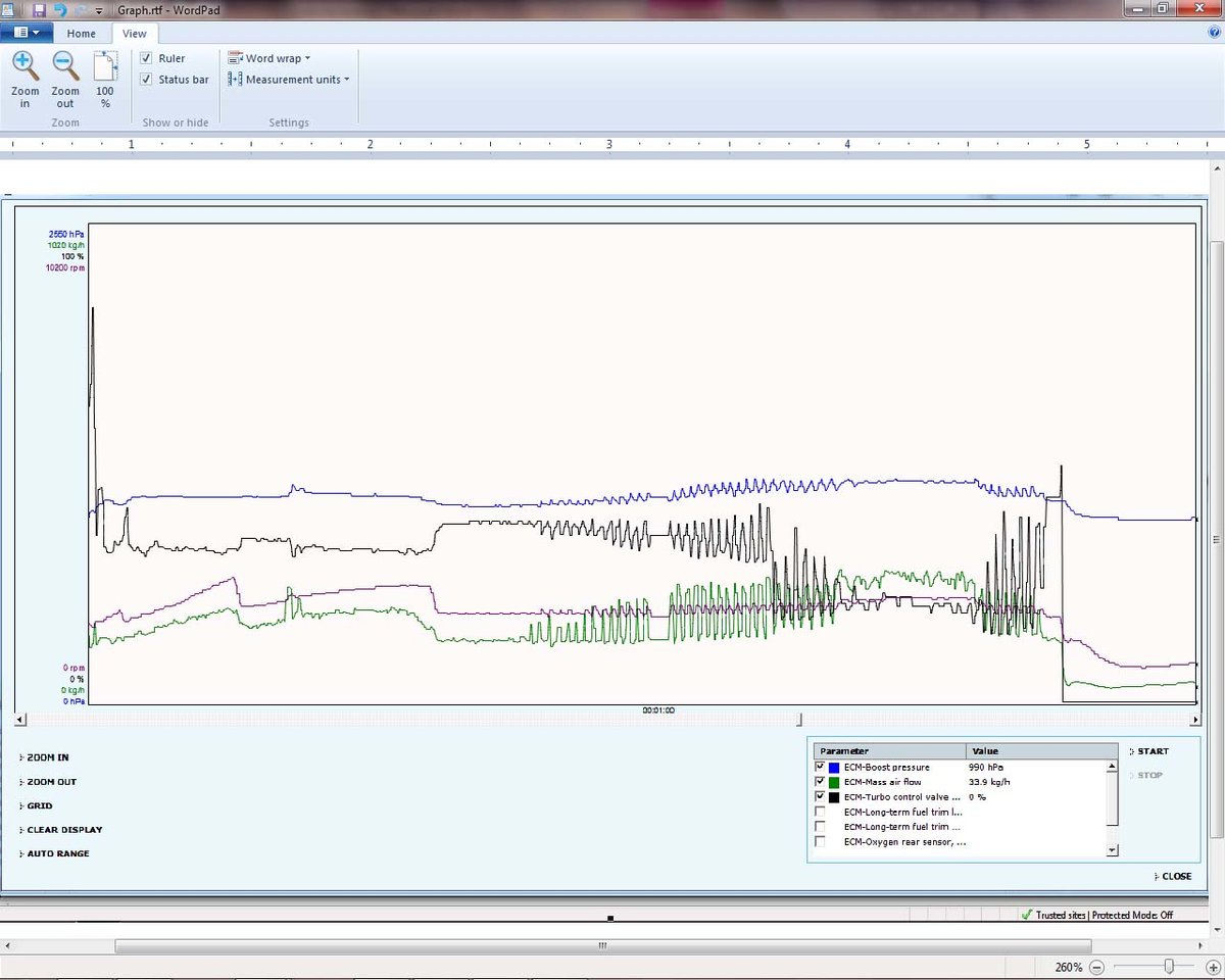

I have removed and cleaned the ETM. I have bypassed the TCV by connecting the boost line directly to the waste gate valve. Neither of these has corrected the problem. I have smoke tested the intake system without any noticeable leaks. I had to replace the MAF about a year ago and I have ordered new hoses for the Turbo Control valve (Should be in next week).
I have a Dice scanner and was able to capture a few images of the occurrence. It is clear that the TCV (black line), Turbo pressure (blue line), and MAF (green line) are showing the pulsations. In the second figure the throttle position is very flat so I do not think it is an ETM issue. The first image has the TCV connected and the second one has it bypassed. Does anyone have any ideas what to look at to solve this issue?
I would appreciate your suggestions.
Graph 2 - Boost (Blue), MAF (Green), TPS (Black), Ignition Angle (Red)  - TCV bypassed during test.  Zoomed in
Graph 1 - Boost (Blue), MAF (Green), TCV (Black), & RPMS (Purple)

First check would be wastegate acutator. The scale of graphs is wide enough that I can't tell what pressure it is actually boosting but a cracked wastegate actuator diaphragm can open when it gets to a certain pressure and cause boost fluctuations when TCV is OK.

The issue seen on the graph is there is an airflow oscillation. The boost oscillates, the MAF signal oscillates and the TCV signal is ramped up to try to dump boost but boost doesn't come down.
The codes may all be the result of the boost oscillations.
The diaphragm in wastegate actuator could be the small vac leak. The MAF signal being erratic could be the fuel trim code cause. The fuel trim code is for lower limit which means it was rich and the fuel trim was lowered 25% to try to fix and at 25% it flags code.
