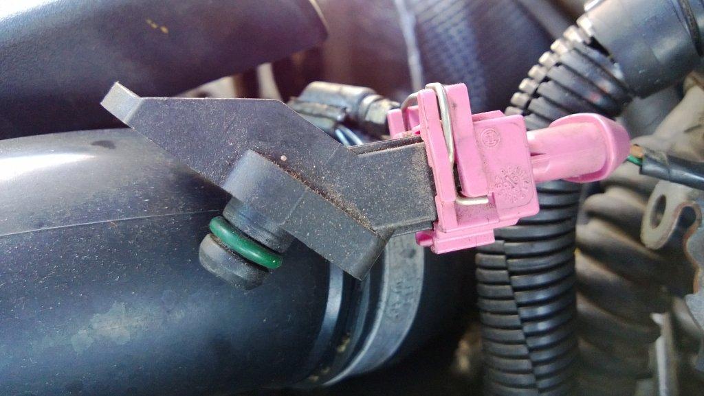

Now I'm not sure whether this is related or not but I noticed this sensor hidden away under the fuse box. I can't see anything that it would connect into, but obviously it does as it has an o-ring seal.

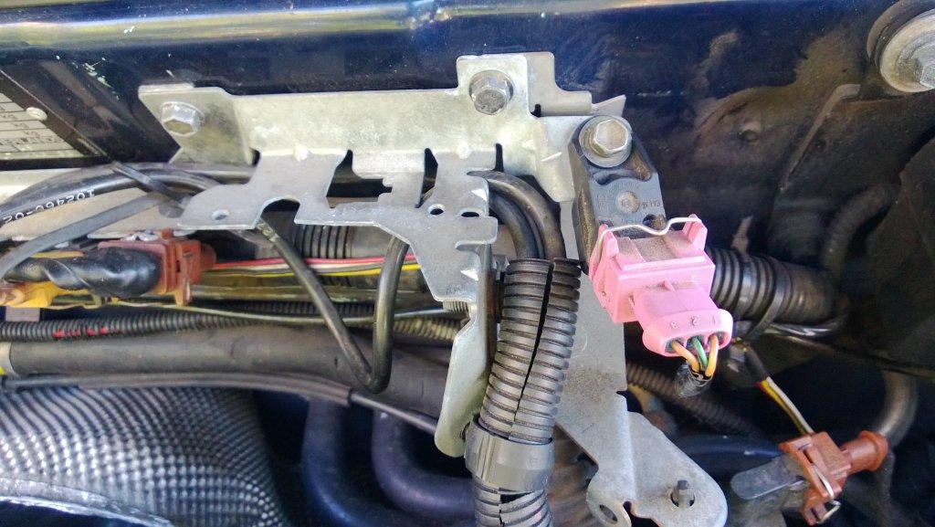

It looks like this must be where it mounts on the firewall;
I've been searching Google for engine bay layouts to try and identify this for nearly an hour with no luck. Can anyone shed some light on what this is please? Also any ideas on the cold engine stalling issue?

Well after researching this all night, I still haven't clearly identified the sensor, it's either a MAP sensor or a Barometric sensor (why does it have a barometric sensor?).

That is a barometric sensor. No reason for the o ring but I have seen many stuck out if the breeze with an o ring on them...

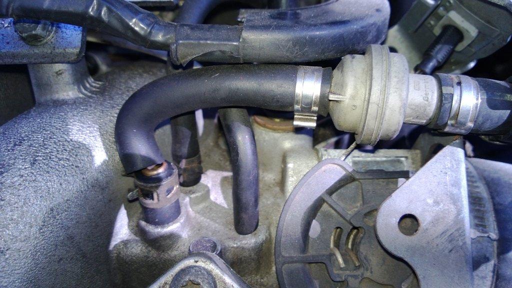

Managed to find the problem. Was a broken vacuum hose on the manifold, once fixed starts and idles perfectly, seems to run a bit better today also. Nice to have an easy one :)
Something else I noticed today though that's a bit worrying, the fuel return line is disconnected and capped off. No idea why this would have been done? Runs fine as is and no sign of any leaking fuel. No smell of fuel leaking back through the vac hose from the fpr either.
