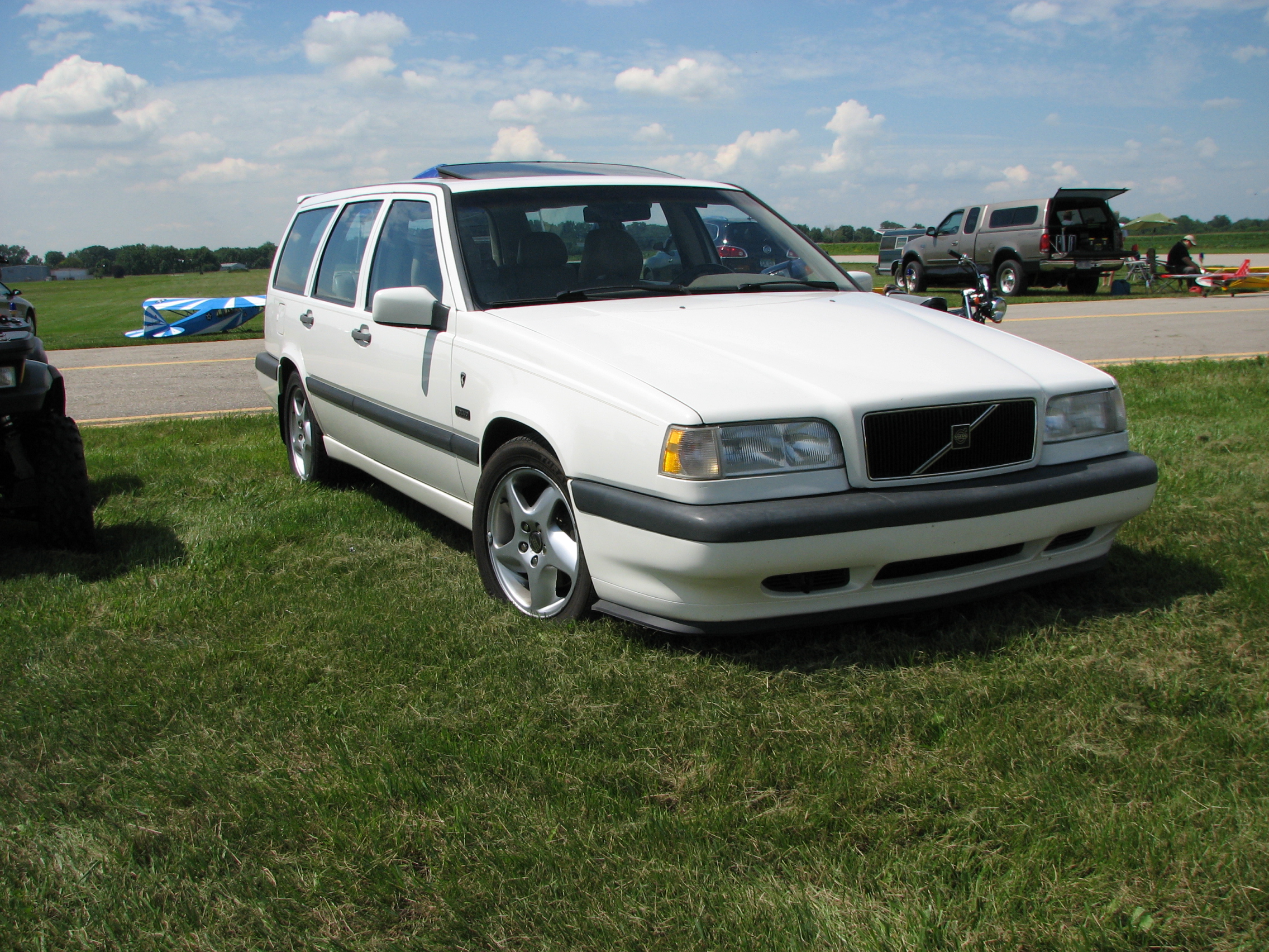

On a side note, my wagon looks just like yours, white, cherry condition :), always garaged, but NA not turbo.

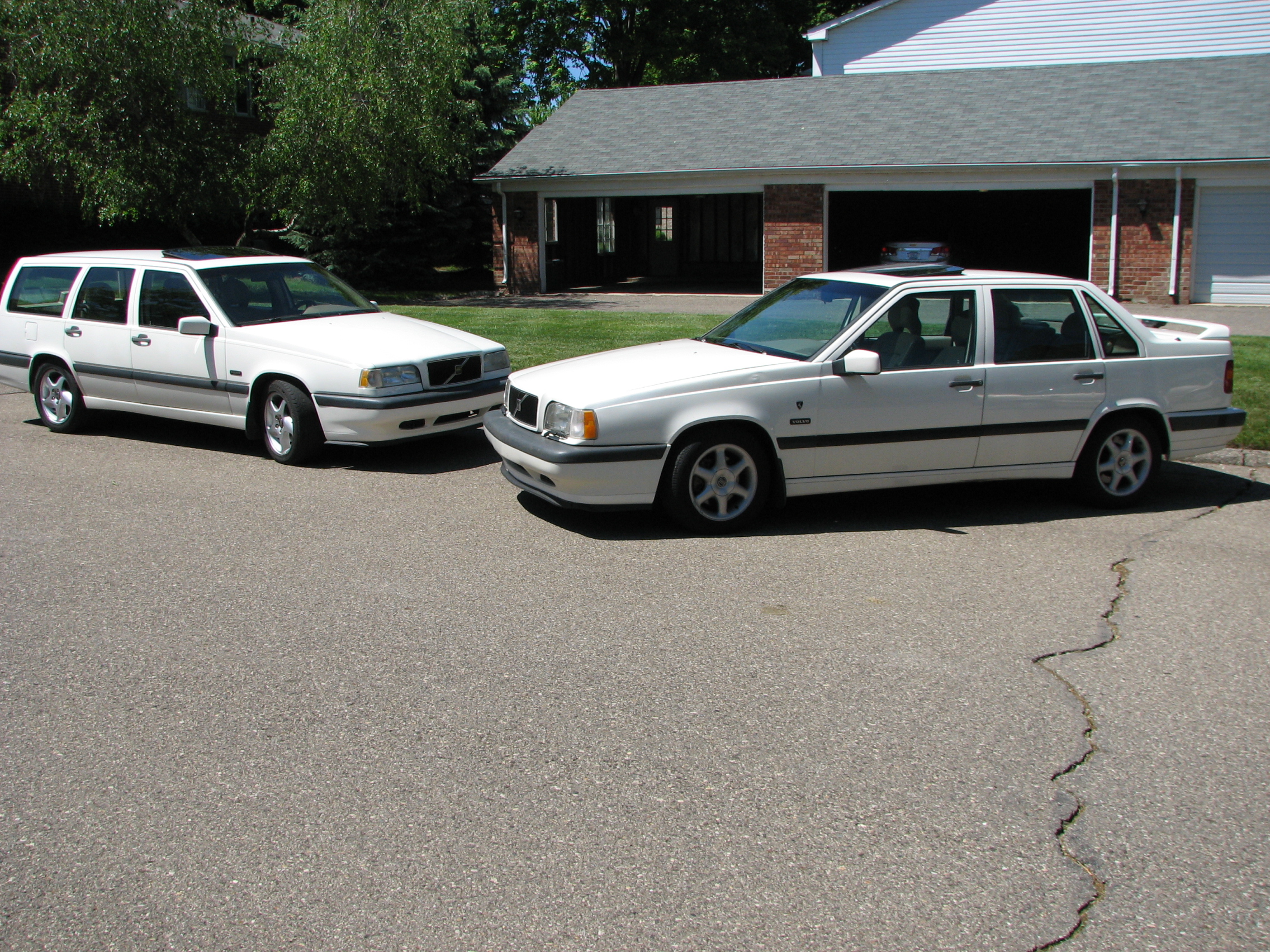

I like 'em too.
"jreed" and myself have nice white wagons. I was fortunate to get this buy.
Here
https://www.matthewsvolvosite.com/forums ... 35&t=56550
I haven't taken any photos lately, but there will be shortly. I had wanted a Turbo wagon, but white sealed the deal.
