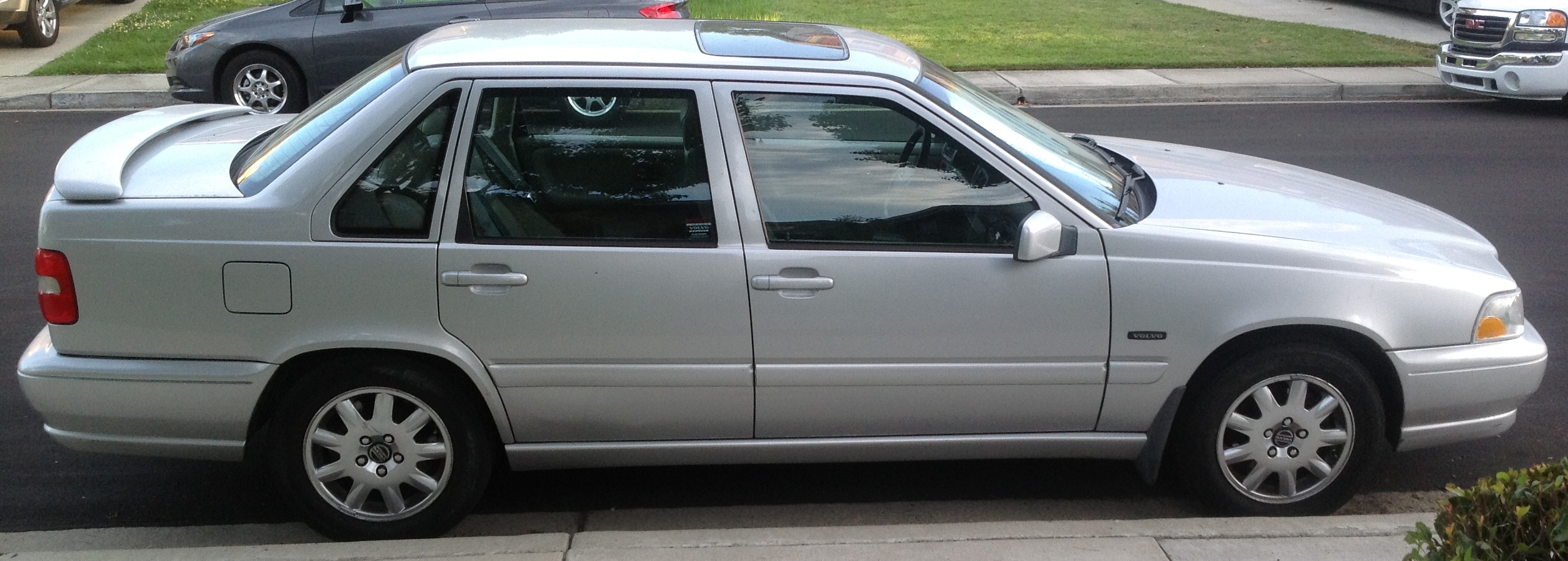

I have a 98 S70 T5 with 333,000 miles on it. I love this car. The front seat needs to be rebuilt but otherwise is in great shape with the exception of the suspension.
The suspension is gone. I replaced the front shocks at 170 K and a control arm here or there but the entire system needs work with the exception of the steering rack.
I want to keep it a T5 with the performance.
Can someone please help me with this suspension rebuild. I am looking for whatever advice and names of parts to purchase. Thank you!
