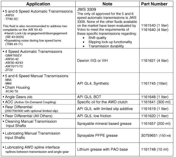

Please see the Volvo fluid chart

As you can see on the page labeled 45 on the bottom. (page 48 of the pdf)
1161 745 is a 75w-80 fully synthetic GL-4
a synthetic 75W-90 GL4 will work fine (Just make sure it says GL-4)
