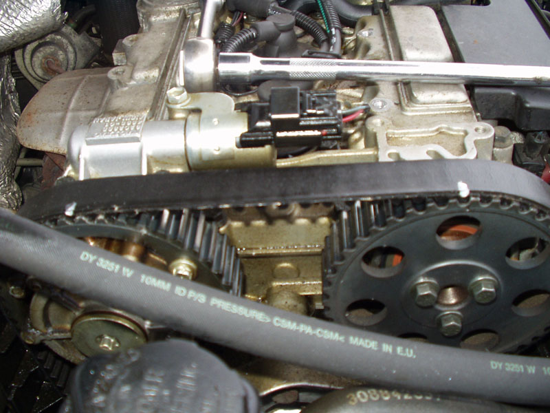

Myo,
No, but I had oil there too. I found this pic on another forum that shows the plunger on the VVT gear better:
The plunger is all the way to the right of the image, under the outer gear.
And here is a pic of my VVT gear that shows where it is better. The gear on the left is the VVT, and you can just see the plunger peaking out from behind the AC hose. You might need to remove the upper timing belt cover to get a good look at yours. There is a 10mm bolt to the left of the engine side motor mount.
I just finished the job a couple of days ago, everything went well. Neither of my cam seals were leaking, but I changed them anyway. And let me tell you, this is a major undertaking. I had at least 12 full hours into it. But way better that paying someone else big $$$ to do it.
I took lots of pics of the process, and made good notes along the way, Ill try and work on the writeup this weekend.
