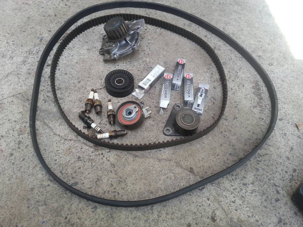

Purchased with 292,478 kms and in need of TLC.
Today fitted new
Gates timing belt,
URO mechanical tensioner,
water pump,
URO idler pulley,
Gates accessory idler roller,
Bando accessory belt
NGK BKR6E V electrode spark plugs
New coolant (Repco)
Oil & Bosch filter change Penrite HPR 10W-50 full synthetic
Flushed crankcase with 2 Litres hydrocarbons (Shellite) and ran fresh oil through to clean the Shellite out.
Tomorrow a Transgo kit awaits the transmission. Noticed an oil leak coming from the turbo area. Will investigate further.
