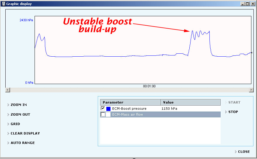

I'm noticing erratic turbo boost development. In second gear, boost builds up steady (although I probably don't notice the issue because it builds so quickly). However, in higher gears, the boost pressure "flutters" - it drops and builds again. It's being dumped instead of holding on to the pressure.
When driving the car, it feels like it speeds up then levels out, then speeds up, then levels out (pulsing acceleration)... etc.
Please see the attached image with a graph showing the boost pressure under acceleration.
What should I be checking? What could cause this "dumpage"?
