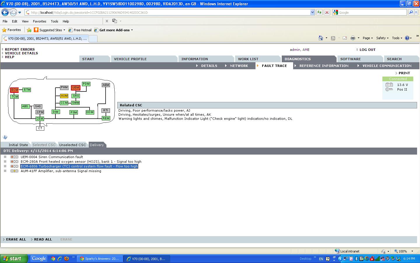

Replaced the MAF sensor with BOSCH original (was 0280218045, I got 0280218108 from FCP), changed the radiator ( it had a hair line crack under top hose) after I put everything together, was short some coolant, so took it out for a half a mile ride, not faster than 35 MPH, at one point heard something like an explosion from the engine compartment- the car stalled for a second, but then kept going.
After I got out from the store, car started and died,,,,3 times...., opened the hood, and saw where the sound came from- the charged air hose from turbo to intercooler- I guess I didn't tightened enough- snapped and that was the explosion like sound.

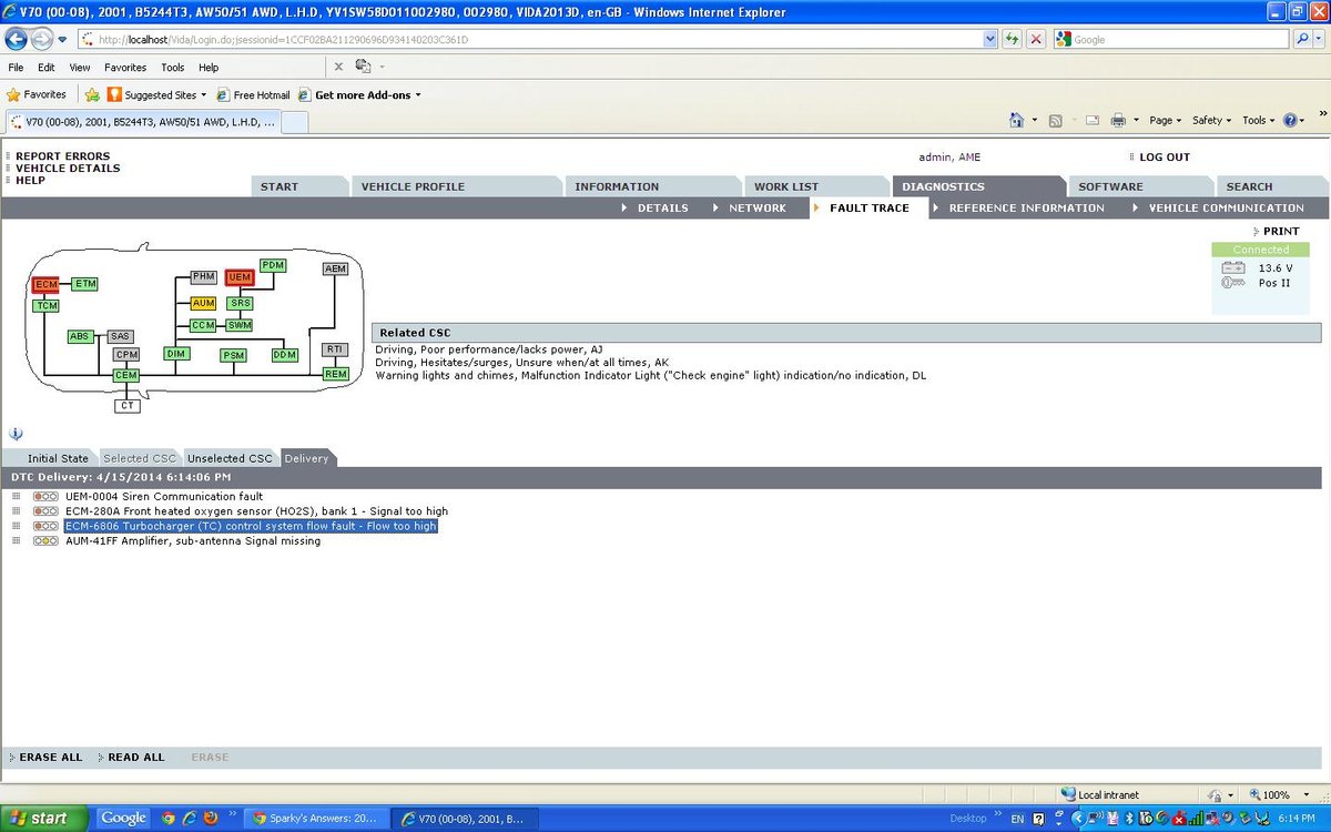

Got home and it seams like nothing has changed, hooked up Vida and it came up with ECM-6806 turbocharger(TC) control system flow fault, at the same time got ecm-280A front heated oxygen sensor bank 1 - Signal too high, I did reset the codes ones more with Vida, but the symptoms are still there- I am thinking the O2 sensor is ok, it is just the mixture triggering it, will look for TC control valve and hoses (silicone as of right now)
Any Ideas or advice?
