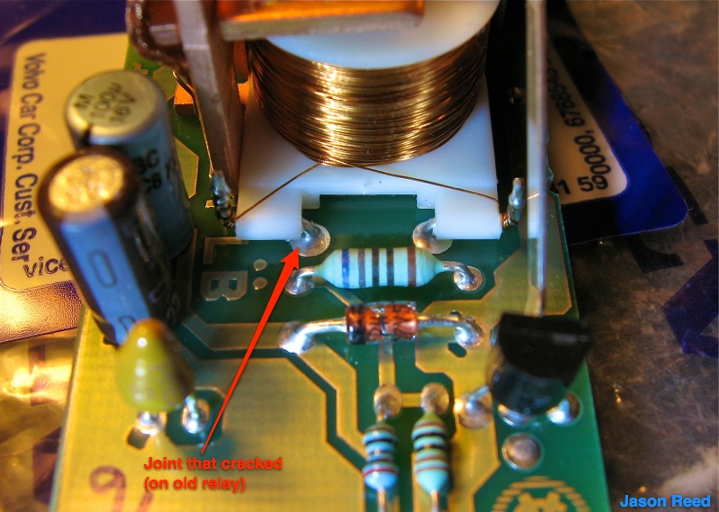

I opened up the fuel pump relay and inspected the solder joints... One of the joints has a crack. This joint had a crack in it the last time I opened up the relay a couple years ago. At that time I added some fresh PbSn solder and reflowed the joint to repair the crack, but it didn't make for a lasting repair.
Solder joint for the coil actuation wire -- cracked again!
Fuel Pump Relay Volvo 850 crack.jpg (133.6 KiB) Viewed 1284 times

Its usually the coils because they are relatively heavy so they have a lot of momentum and force applied to the joints. If it failed again, I would suck up the old solder, clean with a bit of rubbing alcohol and re-solder

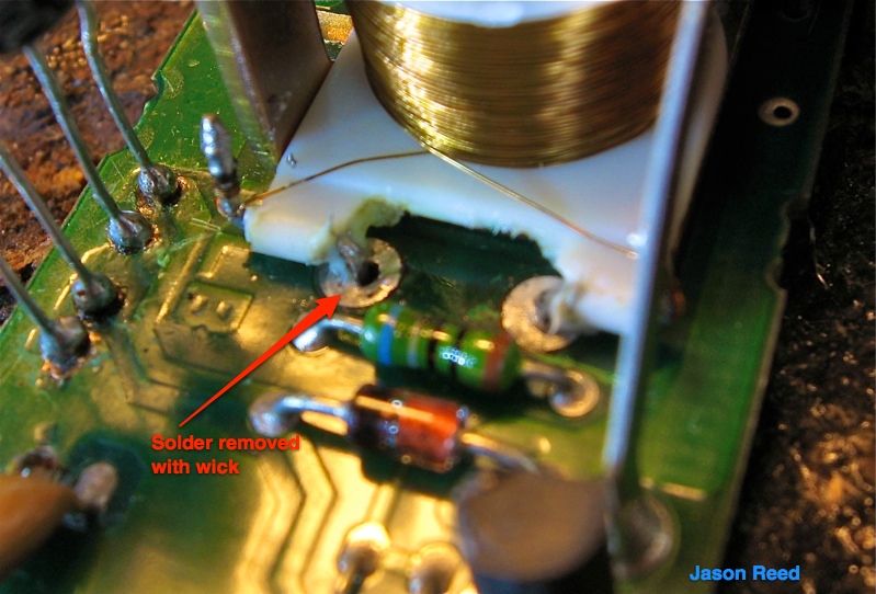

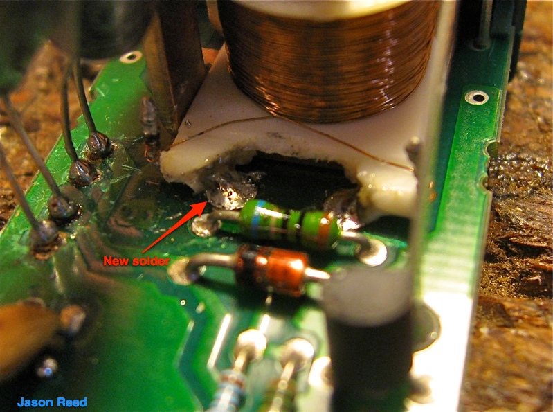

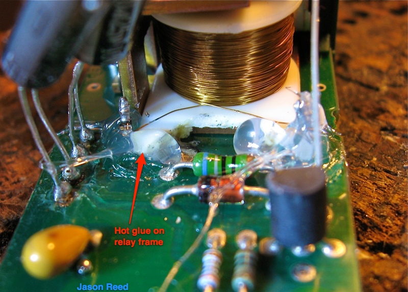

I removed the solder from the cracked joint, applied some fresh solder and then glued the relay frame to the circuit board using glue. Hopefully this will make for a more lasting repair.
Solder removed with 'solder wick'
Solder Removed.jpg (177.31 KiB) Viewed 1275 times
New solder applied to joint
New Solder.jpg (214.66 KiB) Viewed 1275 times
Hot glue applied between the relay frame and the circuit board
Hot Glue applied.jpg (202.38 KiB) Viewed 1275 times

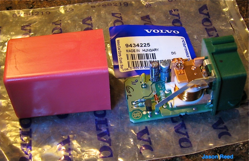

Yesterday the new fuel pump relay arrived. I took it apart today to see what was inside. The case has a clip on each side that you spread and then you can slide off the case.
Opening up for inspection
Taking apart new relay.jpg (197.23 KiB) Viewed 1270 times

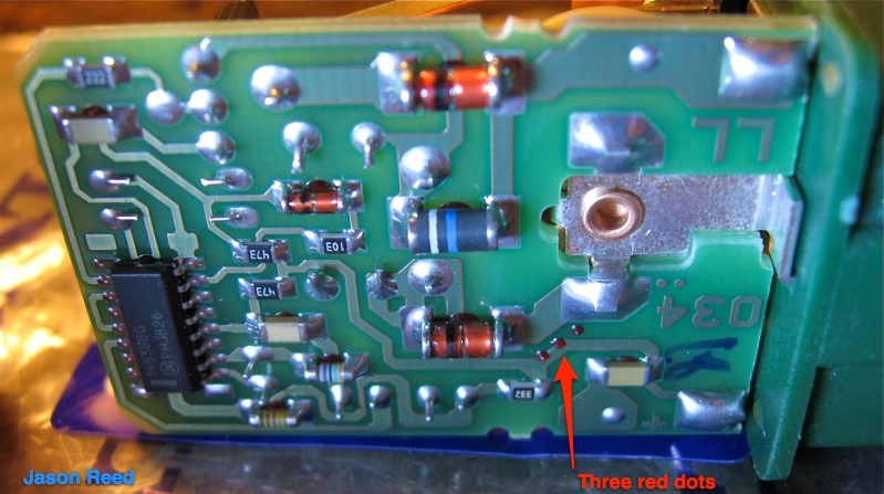

I inspected the back of the board and saw three red dots. They didn't appear to have an electrical function. Then I noticed that the IC and the resistors, chip caps and diodes on the board also have the red material underneath them. I think the red material is a type of adhesive used to hold the components in place to improve their ability to withstand shock and vibration. Or maybe to hold them in place during the solder reflow process. The red adhesive is not visible on the front of the board. On the old board it was the relay solder joints that failed -- maybe they should be applying the adhesive to the relay frame as well to prevent fatigue of the solder joints.
Three dots on the back of the board -- mystery indicator
Three red dots.jpg (158.63 KiB) Viewed 1270 times

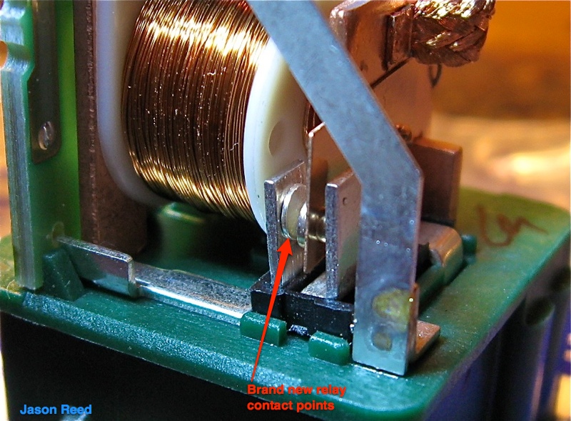

Finally I checked out the relay contacts. I haven't seen brand new relay contacts in a while. These looked silvery and smooth.
Brand new relay contacts
New Relay contacts.jpg (221.17 KiB) Viewed 1270 times
