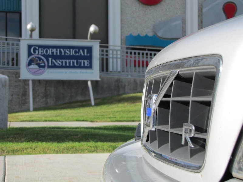

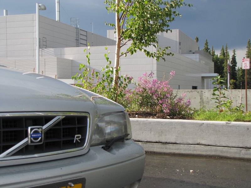

Be advised - The new Blue logo is a slightly different shape than the old Black one.
I just swapped out the entire grill with a newer C/XC grill - More Purtier!
Of course, Then you have to get the center caps...
Entirely up to you!
Entirely up to you!

'99-'00 XC and '99(?) -'04 C70 share the Blue logo eggcrate.
Find a nice one and it will drop right in. EZ upgrade.
