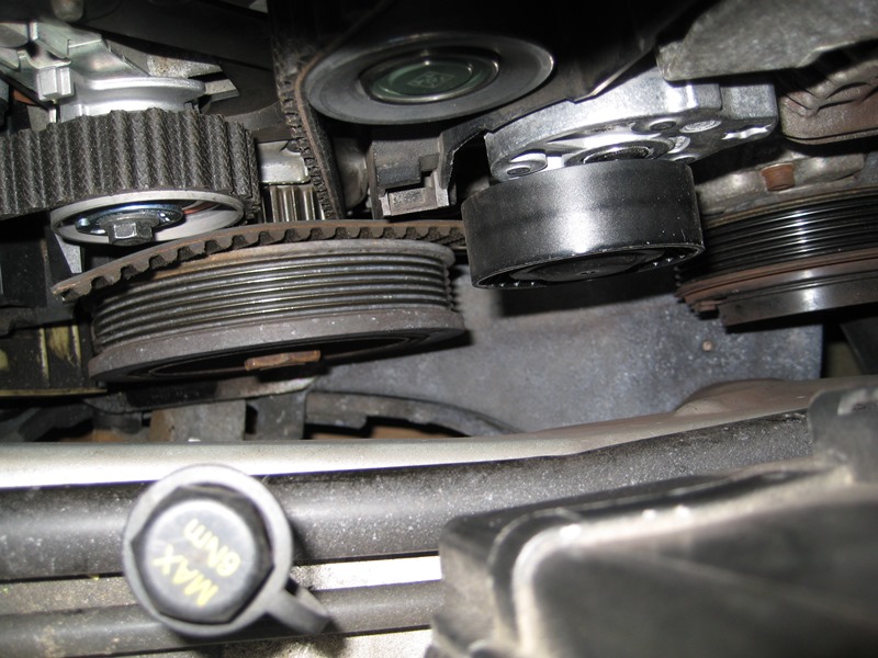

I think many of you have seen FCP’s video “S60 timing belt change”, in which the crankshaft pulley was taken out in order to access the belt. This is also in Volvo’s instruction (VIDA or VIDAS). As a lazy old guy I didn’t really want to go that route while I was changing TB on my 2006 V70 (Engine B5244S), rather used similar way as I did on my 850’s. It worked!
This is how I did it:
Step 1, Remove the “belt protector”, which held in place by two bolts,
Step 2, Slide the belt in from the left side first (easy one),
Step 3, Twist the belt 90 degree(teeth facing the pulley) push vertically strait up first to clear the metal rod, once the belt is there then twist and turn as shelving into the gap,
Step 4, twist the belt again and slide into the gap on the right side,
It took me about 5 minutes got my belt in, I think it would take a lot longer if to disassemble the crankshaft pulley. I cut a piece of old TB to test around first which helps to size the dimensions. BTW, all the pics were taken after the TB is installed.
Replace Timing Belt without Taking out Crankshaft Pulley
