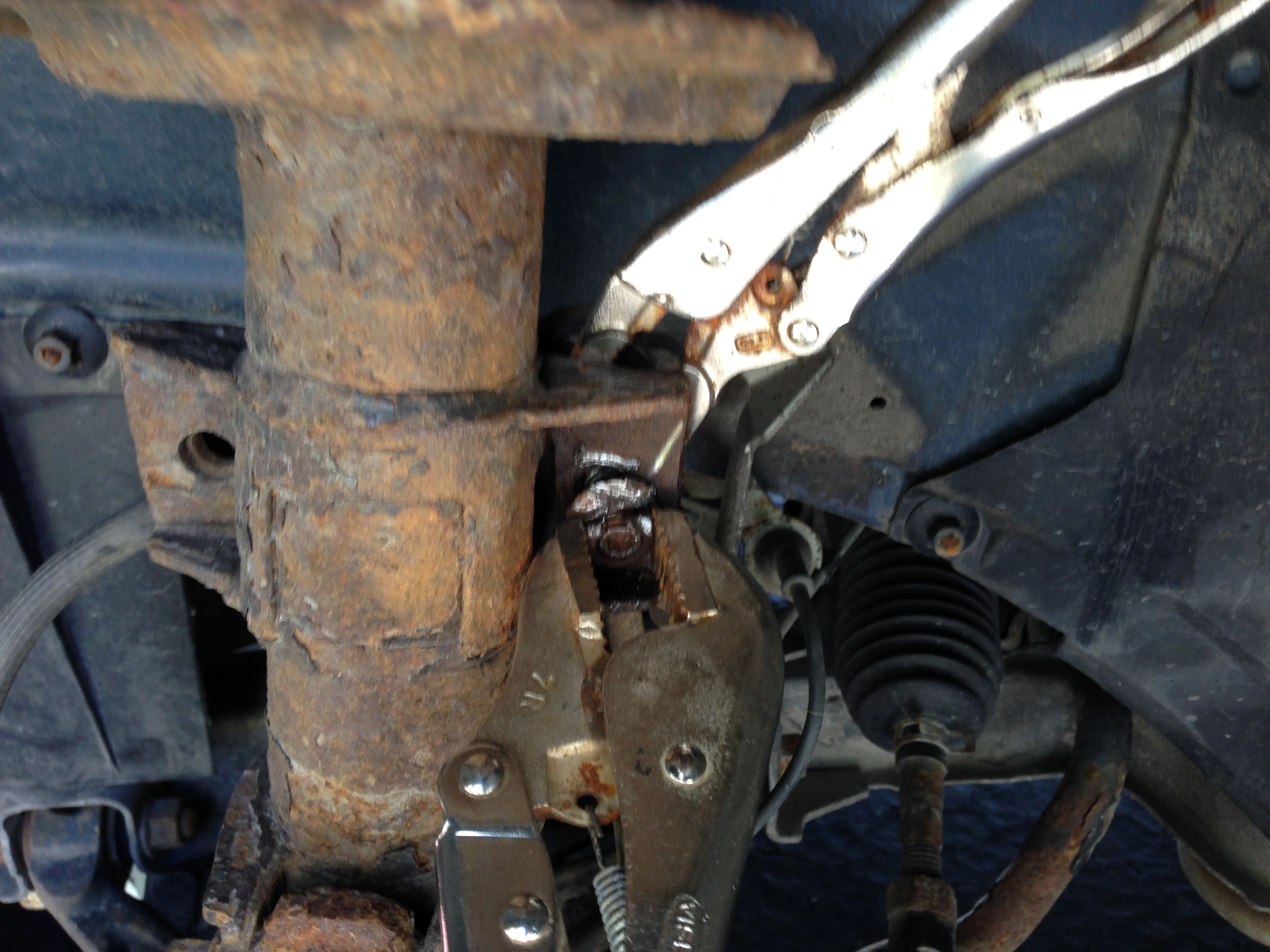

For those keeping score, I decided to replace the bad bearing and both struts. After doing my stab bar links, there was no way I could put these struts back on the car.
