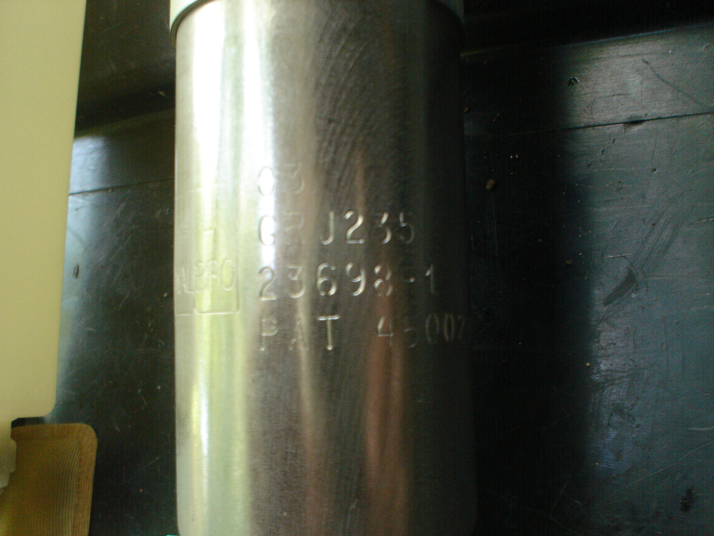

I finally had time to cut the hole in the floor and get the old pump out. Indeed the OEM is a Walbro GRJ 235.

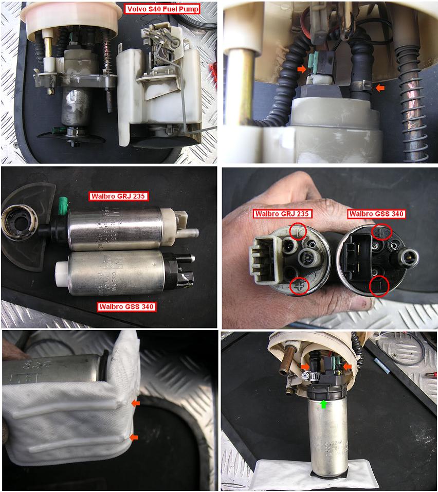

I also came across a post in S40 forum:
http://www.30forty50.com/forum/topic/12 ... ph-340gss/
The S40 model also uses the Walbro GRJ 235, but according to the post above, Walbro GSS 340 works just fine!
Note for Walbro GSS 340:
* It is about $78-$80 on amazon dot com.
* Modify the (+) and (-) terminals as in the link above.
* Re-use the old sock.
Bingo...
